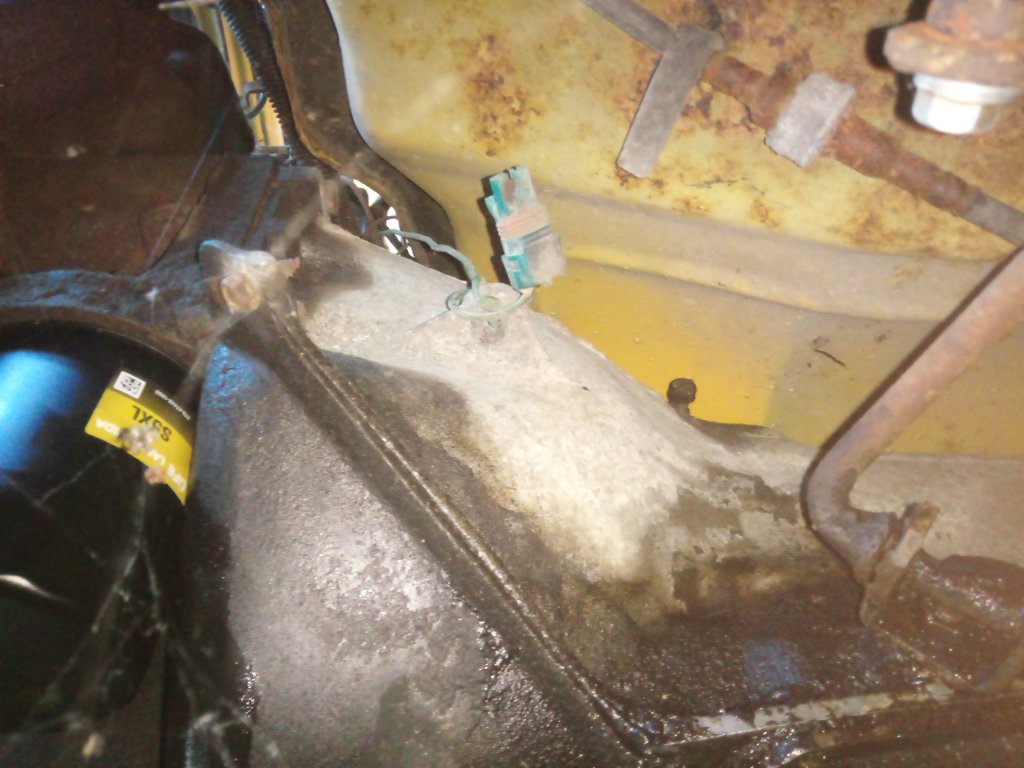

I did find an unused plug dangling down from a wiring harness recently. Someone had tied it to the transmission bellhousing to keep it from flopping around. I'm curious what that is (blurry picture attached), and if it could be useful.

I’ve seen recommendations to tie it to the ignition-on wire for the wipers, but I’ve never tracked it down. My ‘75 K25 has a brown wire under the hood that is used for the relay that disconnects the aux battery when the ignition is off. I don’t know if the same brown wire is on all trucks, but it works fine for my electric choke.

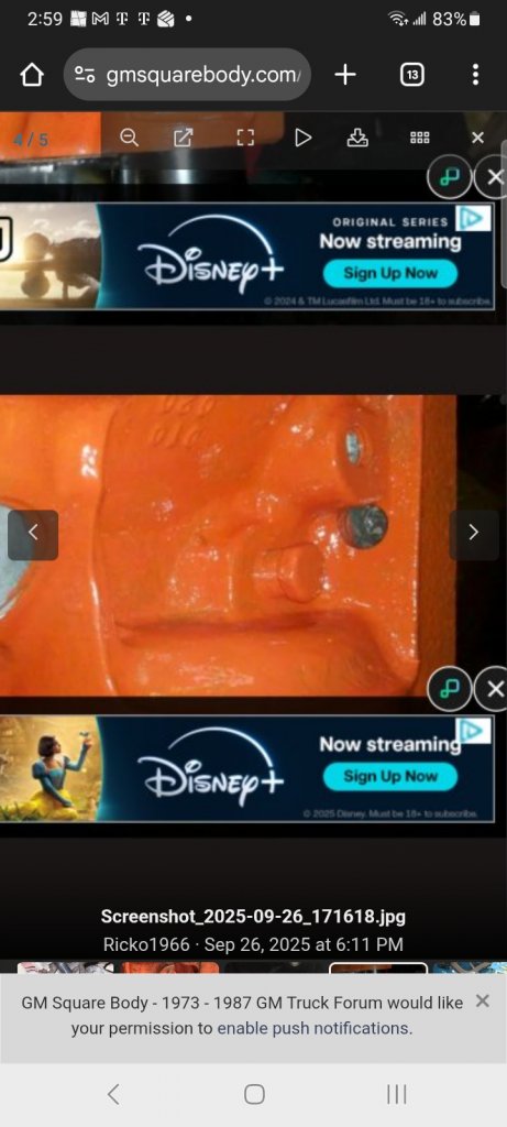

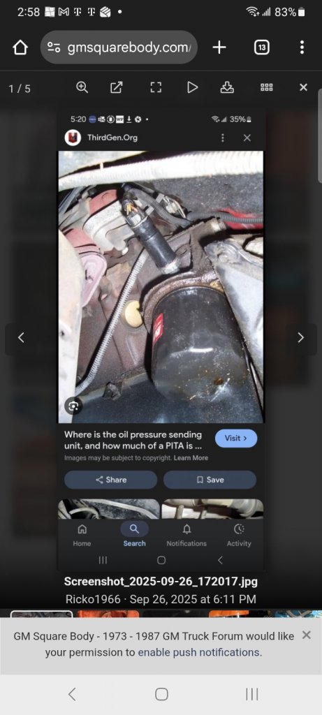

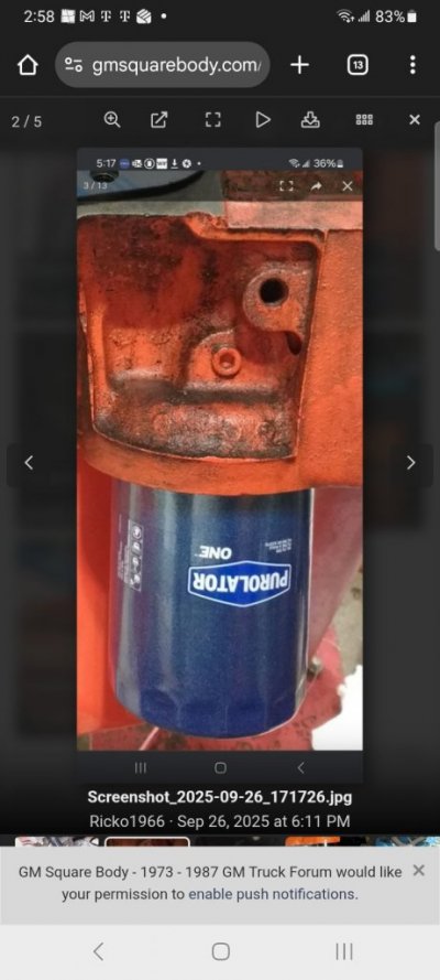

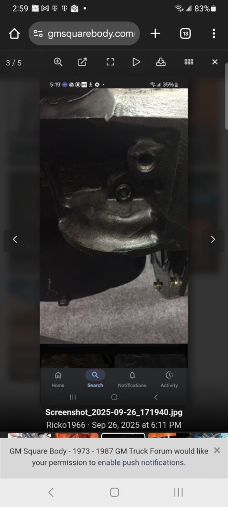

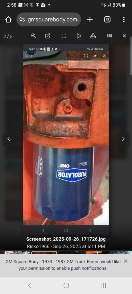

I think you were looking at the hole for the clutch ball,you'll see the plug I'm talking about and it was the factory location for the ps126 I was talking about on trucks that used them. One pic shows the switch for 87 up in place.
As for your DD adjuster screws in a jam I have done both of these. Taken a bolt and a cut off disc to cut a channel through a 5/16th bolt,just big enough to hit the 2 flats. I've also taken brake line/fuel line tubing and squished the end just a little so it would hit the 2 flats.
And adding a relay to terminal 1 at the alternator was absolutely the right move,it's the other way I tell people to do this circuit. Make sure the relay trigger is on terminal 1 on the alternator,but by using a relay it keeps the charge indicator light isolated from the choke coil so the charge light works as intended. Both these methods the ps126 and the relay were factory methods, relays on Gbody's, pressure switch on trucks.

(And Ricko, you are correct about plug above the oil filter. I took a quick look again today out of curiosity, and I was looking at the wrong hole. The plug was there when I looked in the correct spot slightly lower.)
