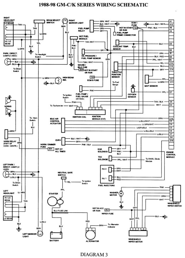

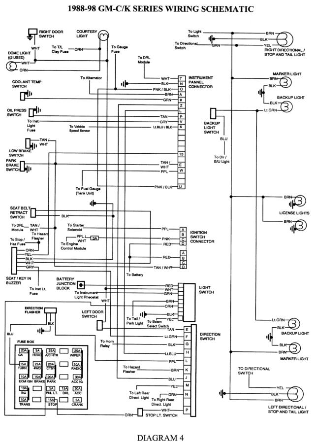

Matt, I see the smog pump has a pink/blk wire so that may be the easiest option. Found these wiring diagrams on another forum so I’m gonna drop em here for future reference. Says 88-98 but I think as far as the TBI it helps for my 87. If anyone has a diagram for 1987 454 TBI Burb I’d love to see it.

In your first schematic there. The grey wire at the fuel pump relay would power the choke only with the engine running if you aren't using the ecm than that circuit would be a very close mimic of how gm did it factory on carbureted trucks. Using an oil pressure switch to turn on and off the choke. Even with the ecm it would still be close.
