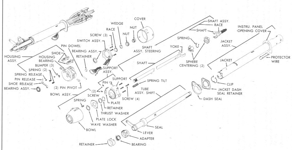

Is this the right diagram?
attachment.php

10-4.
