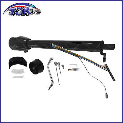

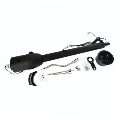

I came across one of those and was wondering if it would fit!
Anyone have experience with this company? I'm not afraid to spend the money for quality but paying over 1k for a steering column seems kinda crazy to me.
ETA: did a little reading and I am going to stay away from these for now. Think I'll save my pennies for a Flaming River. Also considering Speedway. Anyone have direct experience with Speedway?
