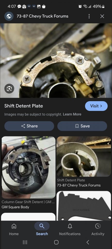

The shift handle should lock, but as described the detent plate has a job so i advise replacing it. may be a good time to do upper column bearings?
Also, look at the transmission lever. is it distorted or bent?
Hows the actual mechanism for the shifter as well, if it was being pressured by a PO and binding it could be bending/worn

This morning, I called "Steering Column Services" and talked to Nick who was very helpful. He said I needed a different detent plate #5994 that should fix the 3 spd to 4 spd column conversion. He also explained to me what to look for as far as the shifter not locking. The detent plate I need is on the way. Thanks to all who helped me resolve this problem. This forum is great for getting the information you need in a friendly environment. Thank again! :favorites13:
