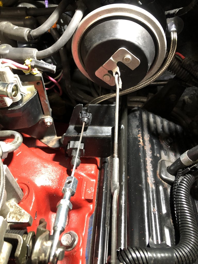

Replaced throttle cable with A Holley Cable, it still sticks cable is very aggressive and rube the housing neat the fire wall, Greased it heavily, still rubs the intake cable housing, I think it needs to be lined up perfectly, Will need assistance for this WAPITA! Still looking foe OEM Cable ?
The cable housing I removed was 20" long New one Like 12"

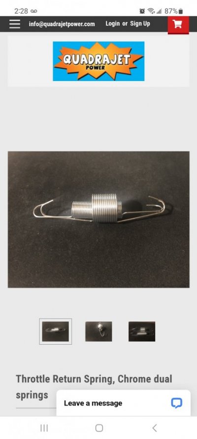

Lets see your return spring. Original spring was 2 springs and pretty stout.

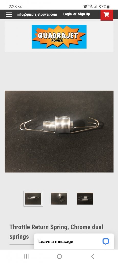

If you're talking about the wound up spring on the throttle shaft,that's not enough,not even close. This is pretty much standard issue.

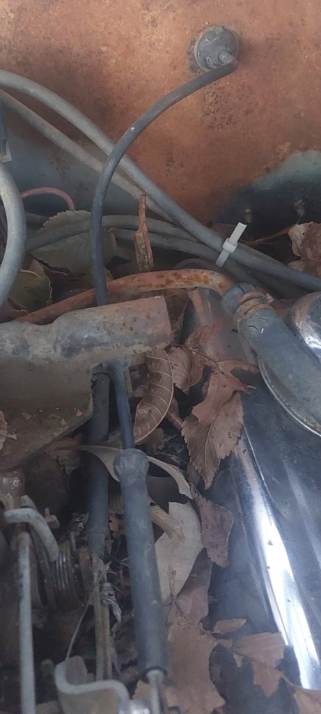

This is where its sticking, cable intake from peddle stainless Steel cable on Aluminum Intake greased the ^%$@ out of it no help. Notice how aggresive the cable is

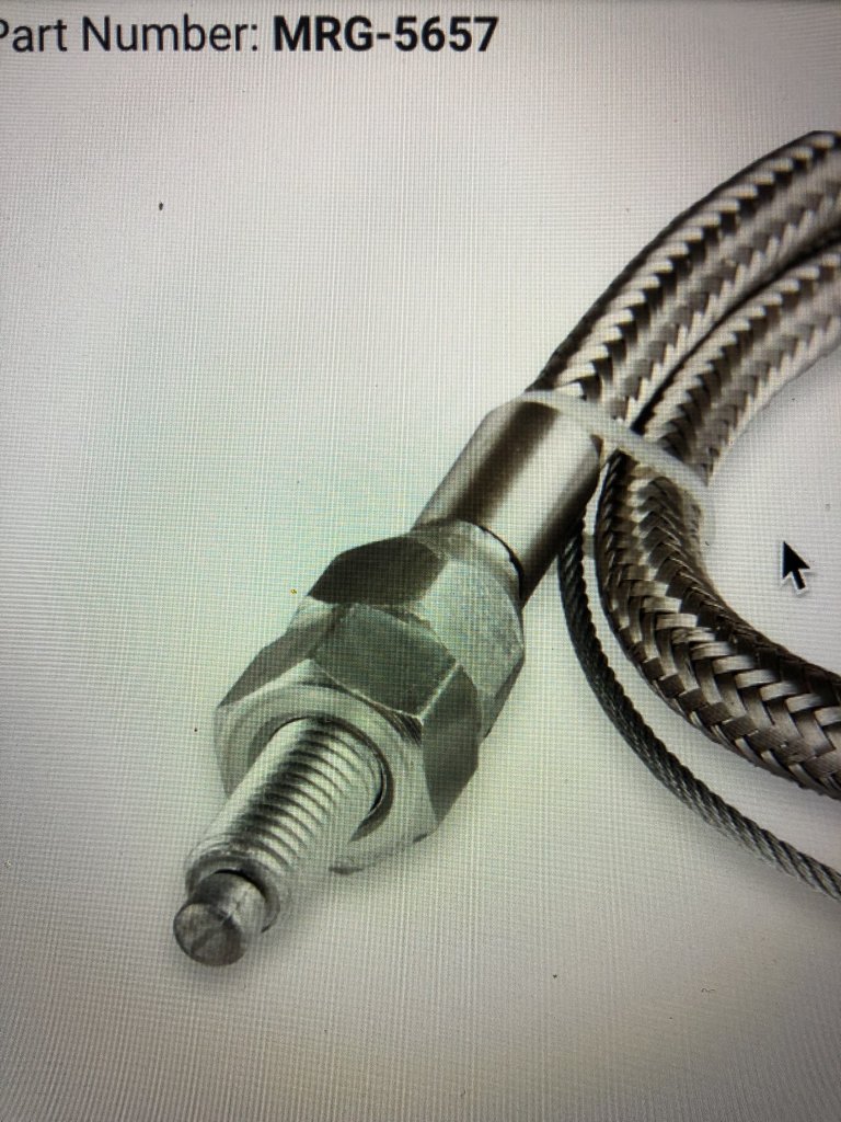

Used the Mr gasket 5657 and now it works great! You can cut it to fit. No more big loop to bind up.
