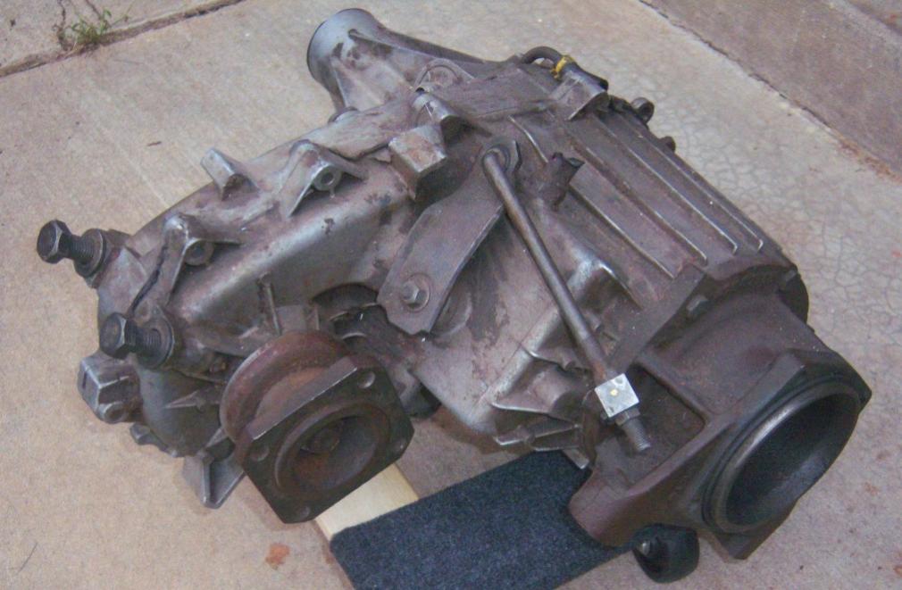

WTH?? DUDE, forgive me, you've got the most jacked up combo I've heard of. NP203 and 700R4 is just wrong? How the hell did they get to that to happen, OK, with a Th350 adapter. and a 700r4 behind a big block? Let me guess, you also have 3.08 gears that I thought was uncommon in 78's? OK, enough baggin on your truck. I'm sure this is something PO did huh? Getting the NP208 behind a 700r4 is simple simple. Getting a NP205 is going to be similar to the mess they used to get the NP203 adapted. Is there a spacer in between the adapter and the NP203? If so, where is this spacer? NP208's and NP241C come with OEM 700r4 adapters in most cases if you find one on CL. I just traded one away, but usually sell them for $100 with adapter in used working condition. That is the easy way out. How long are you expecting thie 700r4 to hold up behind this 454? Do you need the OD? You might consider looking for a Th400/NP205 combo.
