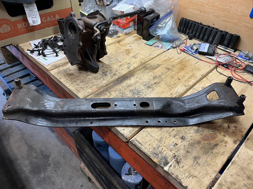

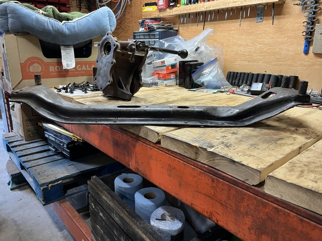

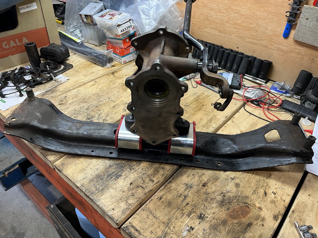

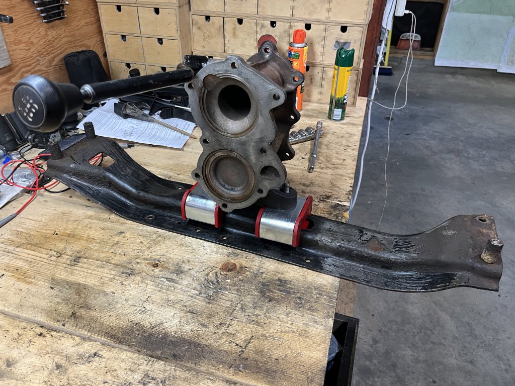

I'm probably going to complicate things here, but it just so happens I recently had my crossmember out from my 1980 GMC K15. It's different than what @nvrenuf illustrates. I guess I can't guarantee the frame/crossmember is 1980 (even though the cab is 1980), but it is 1/2 ton. Here are some pictures. Note that the oval mounting hole for the adapter is on the driver's side.
You might want to see my post "Adapter between SM465 and NP205" which covers the crossmember/adapter install.
