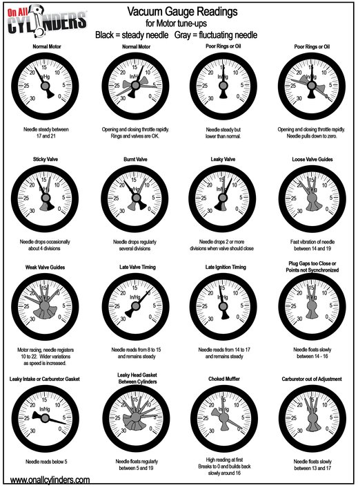

Are you gonna use a timing light to see if you're timing mark is all over the place, or are you gonna turn the crank by hand to check for slop in the rotor turning? A great tool that tells you a whole lot more than you'd think about the mechanical state of your engine is a vacuum gauge, too. Maybe pick one up and see what your idle vacuum is and see if the needle's behaving erratically.
kevinde1
Feb 26, 2017
32
Oklahoma
kevin
5.7l
Well I'm glad you posted that chart, my engine pulls a steady 20 to 21hg at 650 to 700 rpm. I was watching my timing mark with the timing light the other day it was running at about 8 degree advanced and just like a switch flipped it dropped to about 4 degree. My distributor gear looks good and I really can't feel any play in the distributor.

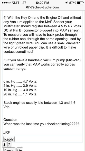

What kind of readings do ya'll get at the MAP sensor output? It seems if I had an adjustable MAP sensor I could set it at 2v at idle and would be good to go, but who knows. I just can't seem to let this MAP sensor thing go until I find out what the correct reading is supposed to be. Maybe my injectors are not flowing well at the low RPM?
Georgeb
Apr 30, 2015
3,259
214
Wisconsin
George
2003
K10 Burb Z71
I have this....
kevinde1
Feb 26, 2017
32
Oklahoma
kevin
5.7l
OK well according to that I'm right on the money as far as volts are concerned.
