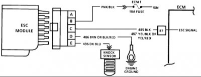

I don't know how to test the ESC other than unplugging it and taking note of a difference in running. I couldn't find any tests or voltage parameters, either. What I can offer you is this. You should get an SES light as soon as you unplug that EST weatherpack connector. Is your bulb working? It should self-test when you first turn the key and then go off. It should have also come on solid if you turned the key to on with the computer out of it. If that's not happening, and the SES bulb is good, I would further want to look to the computer for my problems. Maybe @chengny has the ESC voltages. Here's a diagram of the ESC.

Ok thanks, I have that diagram but still thanks. Yes my check engine light works and I have confirmed it by unplugging MAP sensor. I don't get any codes when everything is hooked up properly.
