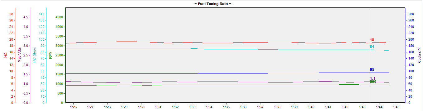

I did not get the surging fixed :shrug: Now that I can read live data I was able to check and set my TPS to .49 VDC throttle closed and also verified the MAP output voltage with my hand held mighty vac at four different vacuum points. On my data stream I can see the rpm fluctuating, the vacuum fluctuating and the map voltage fluctuating all in correspondence with each other but I haven't figured out how it all fits together yet. The IAC was sitting at 90 steps most of the time and only moved one or two steps. Here is a snapshot of the problem area. It starts to smooth out around 90 deg F and the IAC begins to step down.

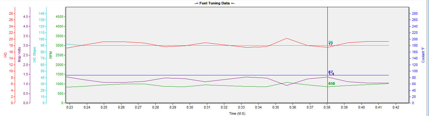

And here is a smoother idle at 95 deg F. It stays smooth like this from here on up. I haven's recorded a "cold" start yet but it idles rather smooth, then gets funky and then smooths out.

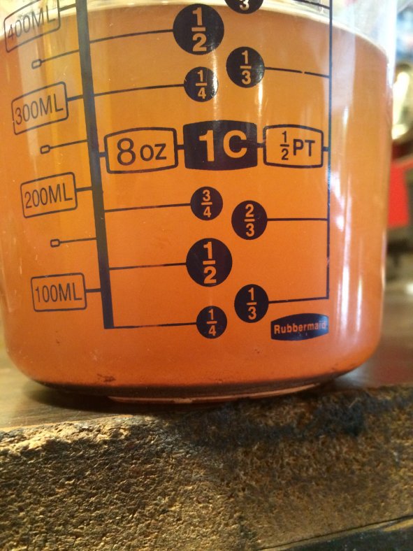

Well, he flat spot seemed to increase and knowing there is debris in my tank I took the fuel filter off and back flushed it. WOW! that thing was loaded. Since I didn't have a new one I put it back on and will be picking one up after work today. On my drive to work this morning I noticed the flat spot has been reduced but is not gone. I should note the flat spot which happens around 8 - 10 % TPS position only happens when the engine is cold and goes away quickly as the engine warms. I have 12 PSI fuel pressure at idle even with a junked up fuel filter but that doesn't say anything for delivery or PSI while under load. Just may be running on the fine line of not enough fuel to satisfy the cold engine but enough when it's warmed up. Going to install a new filter and grab an extra for later. I do wonder if it's another component being flaky but I need to rule out fuel delivery first.
Edit: the gas does not come out of the tank like seen in the pic. This pic was of the contents of the filter flushed out. I am sure I didn't get it all out either.
