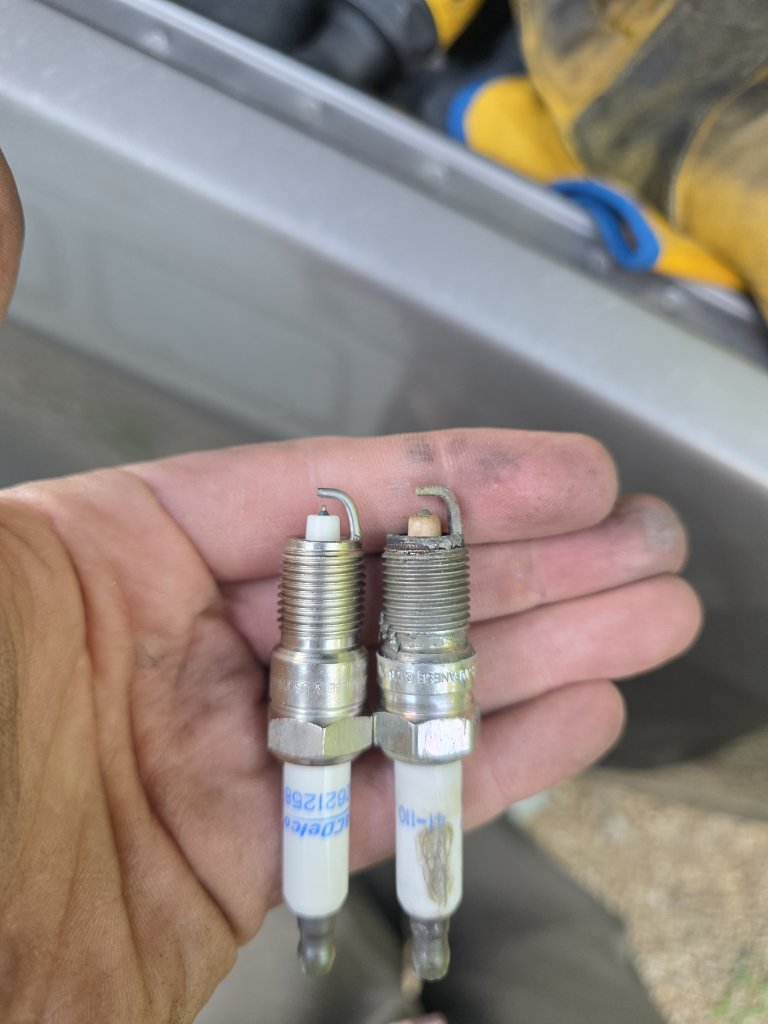

Delco 41-110 plugs. I'm looking for a receipt or something but not finding it. It wasn't Amazon this last time, I know that. I try to avoid potentially scammy stuff, but maybe I just got some bum ones. I dunno, but I'll run it a while and see if they look like they are taking a premature beating and go from there. I'm up for trying different plugs, I can't remember if these were what someone recommended or just the part number I could chase down?
I think the 41-110 is the same plug as the 41-162, but the 41-110 should have an NGK part number stamped on the lip if it is a genuine plug.

Actually, this post has pretty good details about the difference between the 41-110 and 41-162. If you managed to find new 41-110, they weren't made lately. AC Delco discontinued them in favor of the 41-162 because they were switching vendors.
I had 2 in the shed, bought 6 more from my local OReilley. I can't find receipts either way on the old ones, I'll see if they haven't been tossed out yet and get a better look at them, but this is what I have on hand. New and old both marked 41-110, didnt look at the stamped numbers or anything else.
Wow... the entire electrode being gone from that one with only ~30k miles on it is crazy... that shouldn't happen
That's my thought, and all 8 were the same.
It's possible they were a crap set, maybe the electrode was advertised as the correct unobtanium but was actually just cheap stuff?
And it's possible my ADD got me and I put in a worn out set for some reason then just forgot about it (I've admittedly done worse before), but even then, I had the engine apart a year ago and there's zero chance I'd have installed anything that looked like those, so even if they were "half gone", they would have had to lose the other half in 10k miles. I'm just not seeing it.
I'll run these from the parts house for a while and inspect them. I don't know of what else would cause them to get worn out that quickly. and I'll see if I have one of the old ones to check for forgery, but today was trash day and I'm pretty sure they were all in the trash on the curb when I left.
I haven't even looked at mine since I swapped it in a few years ago. That was 30k miles ago. I'll have to take them out and look at them when I do the cam swap I guess.
