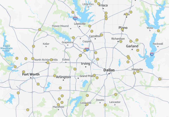

Actually, now that I looked.... you have a ton of stations around you that have flex fuel and blender pumps. You actually get BETTER fuel mileage with up to 30-40% ethanol content than with straight gas. We only have 4 E85 stations in the entire state of Oregon and because there aren't very many the cost is not very different from regular 87. I would kill to have blender pumps like that within easy driving range. I would at least call or drive by the place and see what the price difference is. I've seen people post pics from the DFW area with E85 or blended prices below $2/gal... so i'm surprised to hear you say it isn't worth it.
Here's the Department of Energy website that lists E85 or blender pump locations: https://afdc.energy.gov/fuels/ethanol-locations#/find/nearest?fuel=E85
Here's a screenshot of how many E85 stations are in the greater DFW area, with one located in Grand Prairie;

I live at that dot for Grand Prairie, right in between Dallas and Ft Worth. We go about as far as the center of Arlington pretty often, south to the main highway along the bottom often as well, rarely north at all, and east is the ghetto where I don't want my family going if they can help it... The one station in the center between Arlington, Irving, GP and Euless is honestly in the middle of nowhere about 15 minutes away, and each of the others are 20-25 minutes most of the time, so if we have to use a gallon of gas each way to get to the station, it really is a pain to mess with. On a larger tank, I think it might be worth it, but we don't usually tow with this one, it just has a lot of minivan duty in all reality. What sucks is that the map looks pretty similar for Walmarts, Home Depot locations, and a few others. For being dead in the middle of a huge metropolitan area, we are pretty often dead in the middle of nowhere, relatively speaking.
