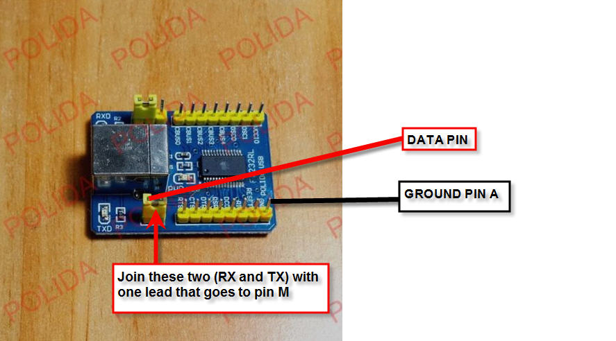

Like this:
Yep, that's correct. The module gets power from the USB connection, so you just need ground and TX/RX to the ALDL port.

Forgive my ignorance but what will I use the definition files for? I am totally new at logging data. If this was a Q-jet it would be fixed already but learning new stuff is good!
They are loaded into TunerPRoRT so it knows how to read the data coming from the ECM.
