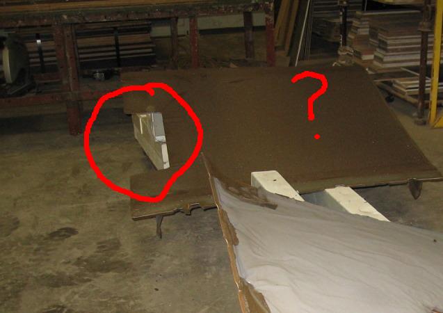

What do you guys think I can do about this cutout in the back? Can I use cardboard to go across it on the top side to have something to glue the material to to cover that hole? :think:

Remember, when you use that adhesive, you spray both the back of the material, and the backer board. Let it set up for about 3-5 minutes, then you lay your fabric on. Once you lay it on, you only have seconds to pull it straight. Best to pull is straight before you lay it on, so 2 people is best. I started at one end and rolled it on about 6 inches at a time pushing it into the backer board pulling out any wrinkles as I went.
Is that hole in the back where the Rear AC unit was at? You could either duct tape another piece in there, or make a seperate piece and layer over the main piece. Might make a great access panel for you to stash your meth for transport and delivery. Imagine the stash you could put in that headliner?

You have rear A/C, don`t you?

He took all his AC stuff out of the Burb. All the underdash, firewall and I am assuming now the rear unit too.

Yes, all the A/C **** is coimng out, so I need to cover that hole. I can use sheet plastic or maybe some very light balsa to fill in that square. :)
I'll need to cut a piece to fill the hole in, then cut a larger one to back it and splice it to the top side of the headliner. :High 5:
