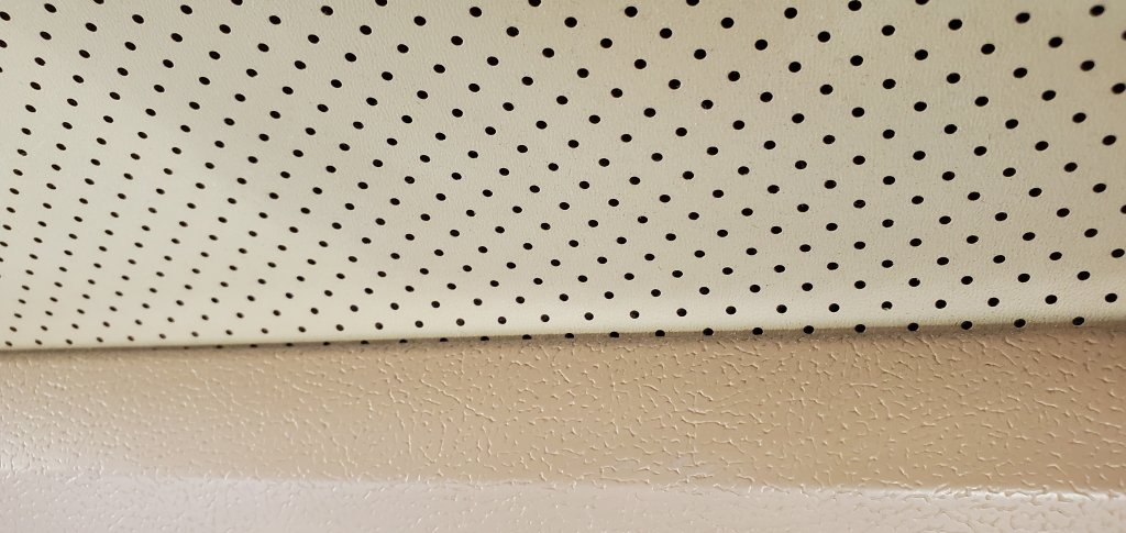

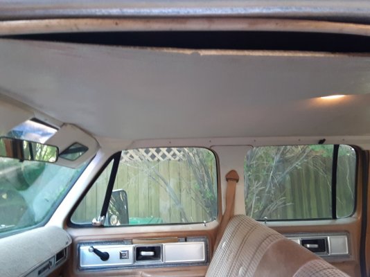

Hi,
I am not familiar with the term "snakebite perforated vinyl".
I don't really know what the difference is between snake bite and regular pattern.
I have attached a pic of the original headliner in my '81 Silverado.

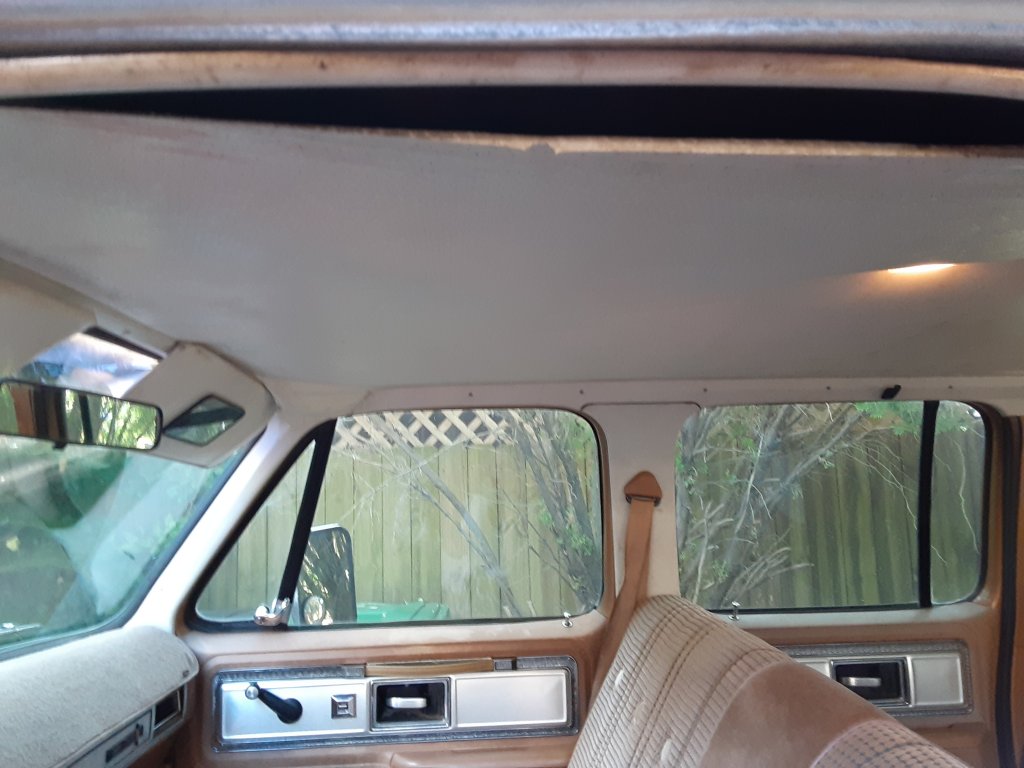

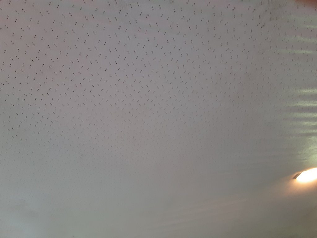

Hi,
Snakebite is kind of a diamond pattern.
EDIT- better pic of the old.
My new headliner is from Classic Industries - it is NOT correct, but it is in there and does not sag ...

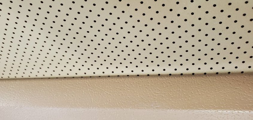

Okay .. My 1985 K5 Silverado came with the Snakebite pattern ... Off White with Foam Backed Vinyl.
I am the original owner so I know exactly what came on the Blazer from the factory.... 38 years now ..
It took me two years to find it, but I did find original pattern ...
I was going to have my original headliner board recovered but it got damaged at the upholstery shop so I bought a ABS uncovered headliner from OC AutoCarpets and had it shipped to the upholstery shop to have my headliner placed on the bare ABS Plastic Headliner.
You are correct no body sells Snake Bit Pattern vinyl as replacement... the are all perforated in a diagonal pattern. you will have to purchase the Material on your own and have it installed.
I bought mine from https://www.headlinermart.com/
I spoke to Jim at 817-562-2381
Jim knew exactly what i needed.
In the picture below you will see a small strip of headliner that was under the front windshield bar and you can see how close the colors match ... The other picture has a piece of headliner that was under the sunvisor.
Also, during these years, some had colored headliners to match the primary interior colors, mine came with the upper portion off white and lower portion all blue. i.e. the A and B Pillers and top braces were all a Mystic Color.
