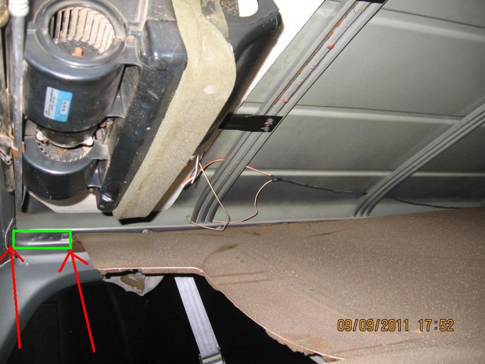

I went back and looked at the pics, that center hole in the rear for th a/c, even if I fill that in, the headliner is still too short....

The front trim around the top of the windshied and the 4 doors have to come off, the grab handles above each door, and sun shades have to come off. Trim piece above the second seat running across comes off.
In the rear, just take the screws out of the top of the trim to loosen it. I was able to wiggle it out back there. There are bolt points omn the top, for the 3rd seat belts, I didn't have to take them off, but it would probably make life easier puuting it back in.
Now mine had the rear A/C so I don't know what the tim piece looks like across the back of the truck on a non a/c rig.
I never thought of stapling it, I wish I did. I used thumb tacks instead, and sometimes they would fall out and stab you in the ass,lol.....
I also accidentally snapped my mirror of the front windshield pulling the headliner out, so I would recommend taking the mirror off too. Now I have to glue mine back on....

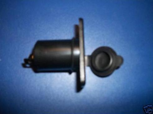

So for an update on this, I dug into it over the weekend to start getting ready for the headliner installed. Running the wiring, I installed a auto dimming mirror with compass, and ran the wire for the two rear 12 volt socket ports, the new 12 sockets and headliner material should be here by this weekend. Then I finish wiring in the rear sockets and be ready to attack the headliner remake on the next weekend I am stuck indoors.
Also, the thick purple wire is indeed for the rear fan, and is hooked to the switch in the dash, so I can turn it on or off if one of the kids leave something plugged in back there and I park it I can make sure the juice is cut off so I don't return to a dead battery. :waytogo:

Got the 12v sockets in the mail yesterday, and I expect to see my headliner material when I get home later tonight! :High 5:
