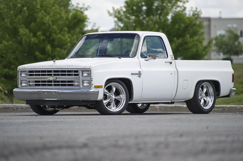

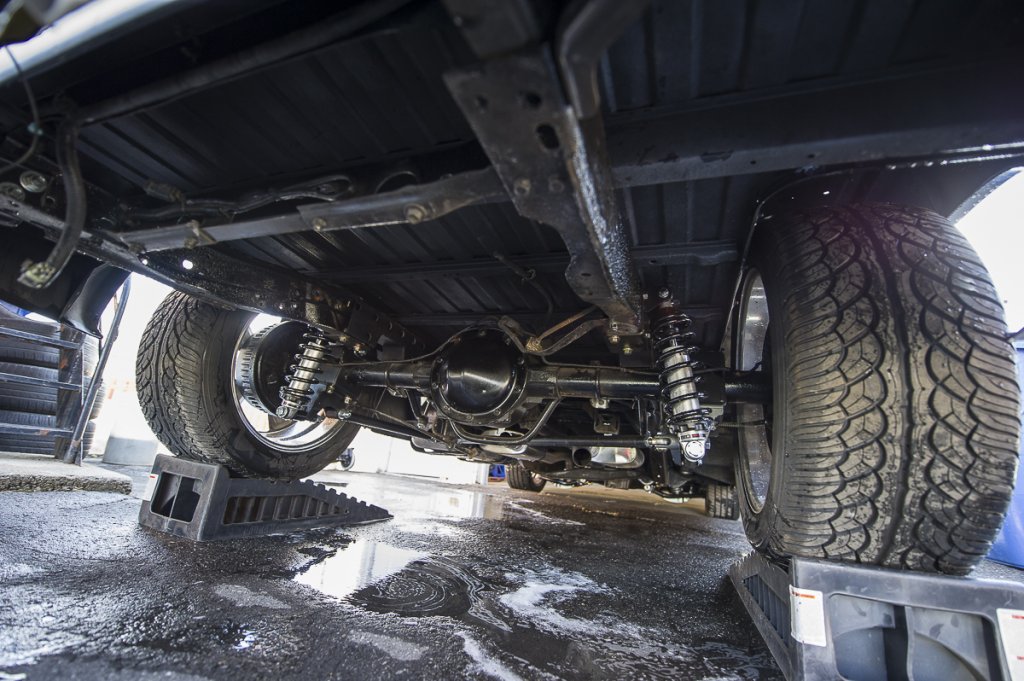

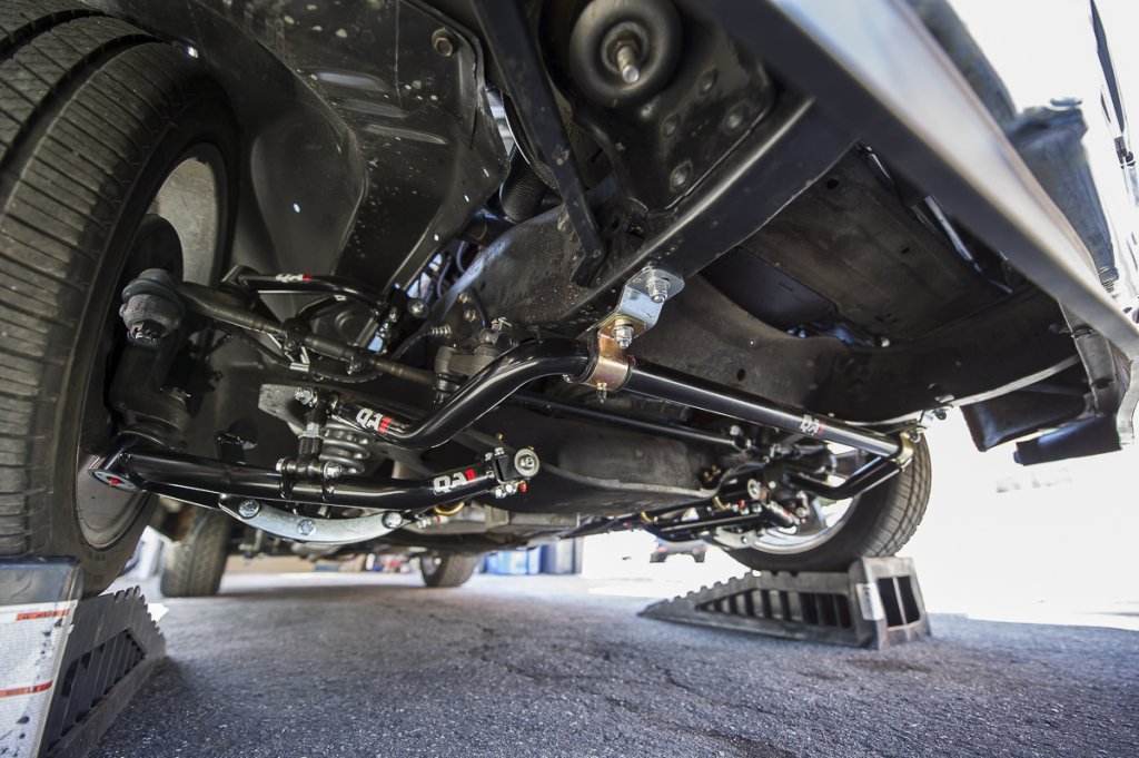

after a few cheap drop kit i made the big move: QA1 front kit and TCI rear yes it cost more but at the end i just want to love my ride..and man i love it! :D
I’m tossing around upgrading to that front kit on my Burb. Was the install pretty straightforward?
That thing is gorgeous! I'd love a full QA1 setup, but I gotta spread the butter I have over the whole slice of bread- funds are limited. It's a long term project, so a high end setup will definitely come along later down the road.

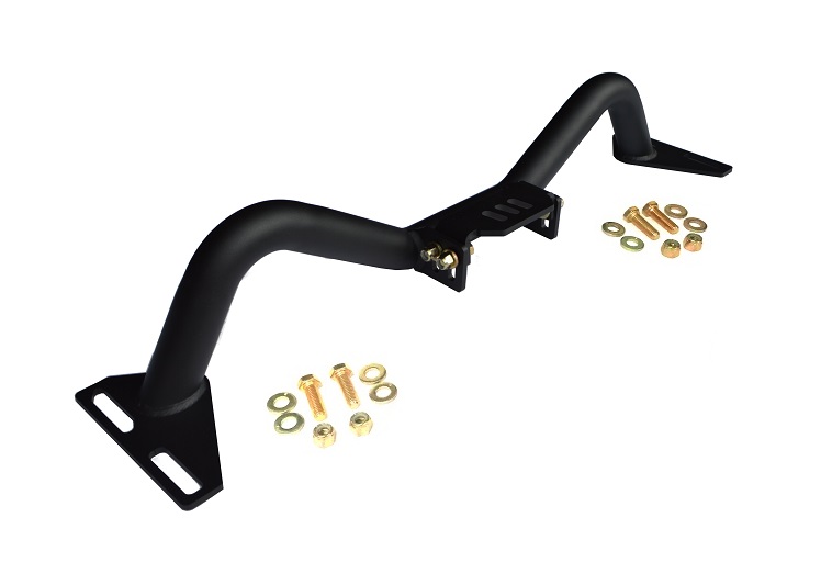

All the advice above is sound. I'll add a couple notes from three years aof driving a '73 10 that was lowered by the PO
-- I recommend an aftermarket transmission crossmember that has the "bat-wing" design like above, so that you can route your exhaust more directly and don't end up with "oval" pipes from getting slammed against the road.
