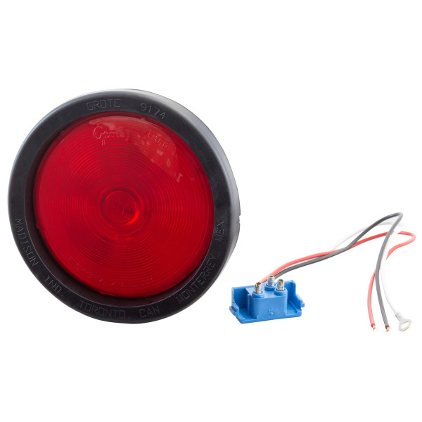

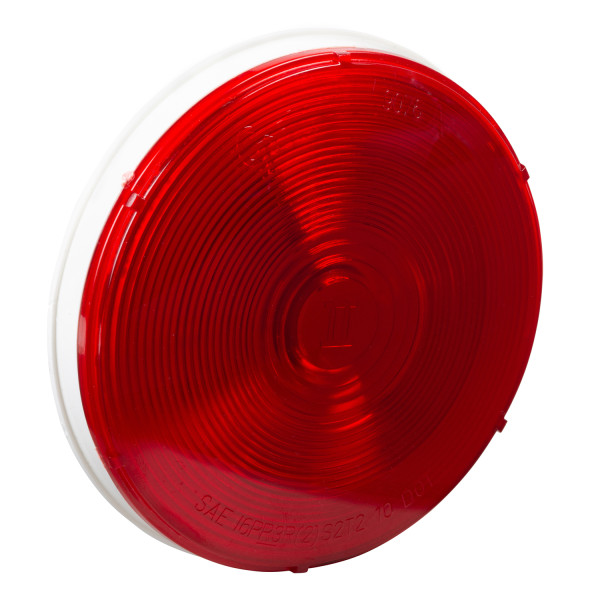

Grote is still making lights.
Grote marker lights
Tail lights in 4" round holes:
They mount with a rubber gasket.
Many companies making these in incandescent and LED lights.
Signal-Stat, Federal-Mogul, Dietz as well as Grote.
