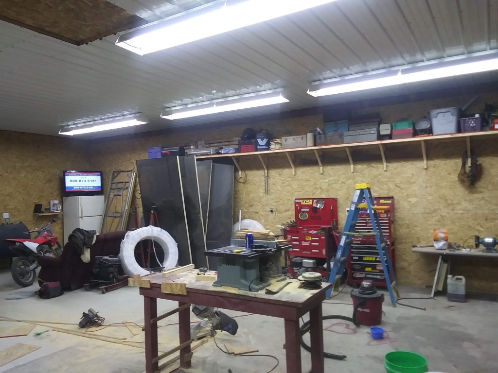

Put these in my 8ftx4 bulb fixtures that came out of Mitsubishi in he transition to rivian pulled the ballasts and good to go I'm running 6 total fixtures so 24 bulbs. Great company when I first got them one bulb was half out, messaged the company they sent me a free 12pack. (Bulbs) for a good review. Haven't had one burn out in 6+ years theyve been in, mostly always warm hot in shop as it's heated by wood boiler but not cooled.

That looks great! Thanks for the info.
