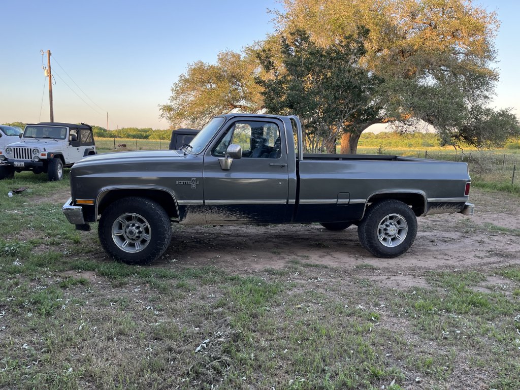

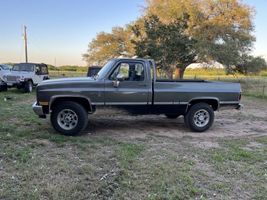

I have this exact same set up on my '86 K20 but with a Toyo AT3. Pitman arm rubs at full right turn for me. Does yours?

No rubbing here. I have 1/2"+ clearance between the drag link joint and driver-side front tire at full lock to the right. My previous tires (over 12" wide, and on the truck when I bought it) *did* rub when turning to the right. I had Discount Tire confirm the fit of the front driver tire before continuing the tire install.
Keep in mind that my M1008/K30 has the Dana 60 and different steering components than your K20, so it's not an apples-to-apples comparison.

Appreciate the wisdom. I’ve tried two different sets of aftermarket wheels on mine and even at 125 ft/lbs on the lugs I can feel them weeble wobble driving on smooth highway for poor Chinesium manufacturing and lack of hub-centricity. In the interest of not prematurely killing wheel bearings I’ll stick to the h2 wheels and live with the rub until I can devise a solution. Might be a death wheel action in my future.
