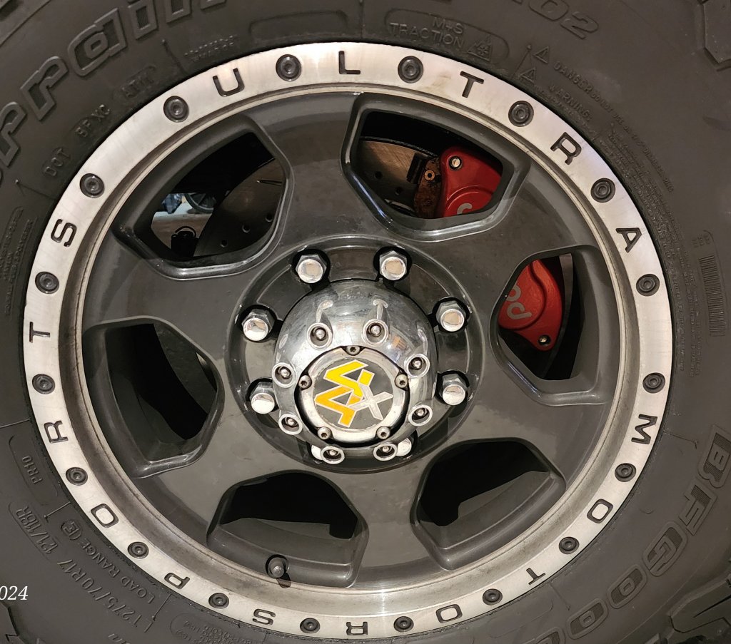

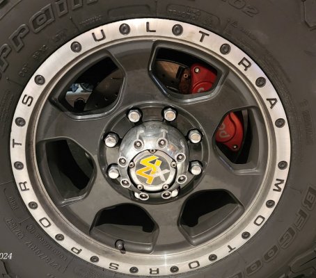

whats size did you choose? What offset? Can you post a picture of your rig with the new rims? Really interested in getting the outlaws on my C20
Rims are 16x8 AR62's
Tires are 285/75R16 (about a 33")

Thanks man, that’s beautiful.
Is that a C20? Did you give it a 2” lift to get those tires in?
Thanks dude.
K20. Pretty much just new springs but it worked out to a 2" lift. Tires would have fit but looked a tad cramped. I like them subtley stout - not slammed or jacked to the moon.
