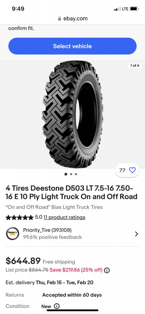

You can get the full on LT235/85r16 equivalent “Co-op Grip Spur” shipped to your house. Deestone 503 in 7.50-16LT is still made in 10, 12 and 14 ply ratings, still bias ply. The Gateway Bias Buckshot is also still made, basically a 33-9.5-16, which in reality is a LOT meaner tire than the Grip Spurs ever were. Unfortunately the Gateway is a load range C, 6 ply equivalent, so 1/2 ton or lighter.
