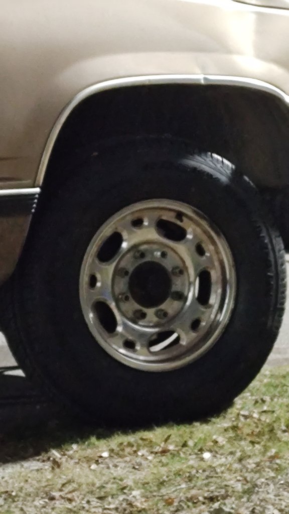

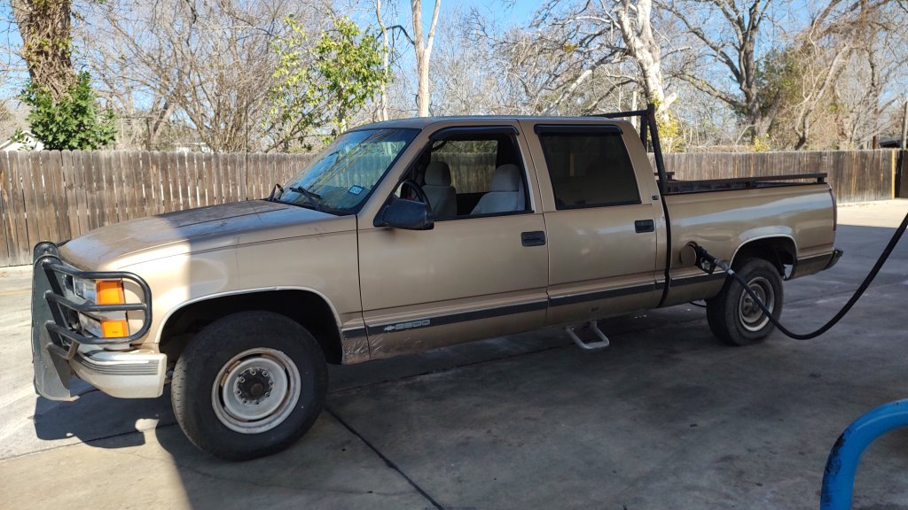

Phord used a dog dish hubcap on their 8 lug trucks....I don't know if the center hole/hub size is the same or compatible with the GM though. The 400 series 2500/3500 either had Argent (silver)steel wheels with center caps, or white wheels with full wheel covers. Silverado had chrome plastic center caps and stainless steel trim rings, lower level trims got black plastic center caps and no rings. Both types of center cap use the "jelly" emblems that melt and look terrible..... like the rear cap in this picture. All four are like that, and the caps are cracked so I'm not currently running them. I want to run the 800 alloys but there is difference of opinion on whether you have to trim the back of the caps to run the 400 cap. But I got one on it yesterday, blew a tire on a curb and had the wheel to trot to the tire store.
