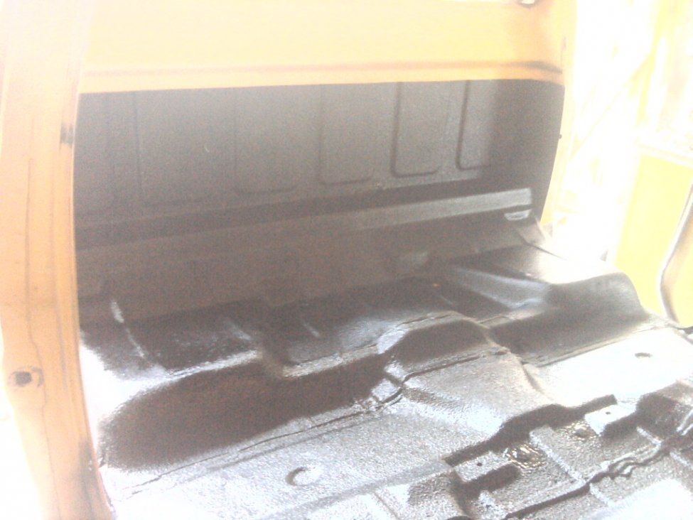

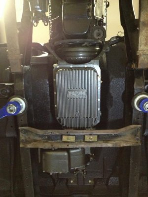

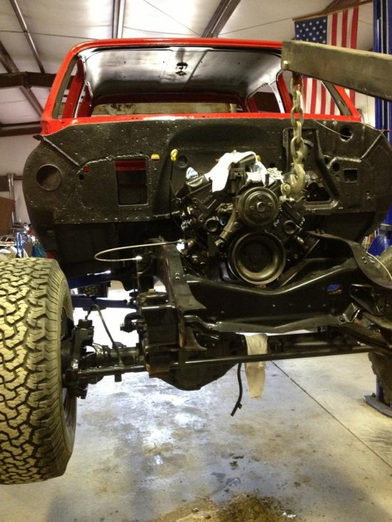

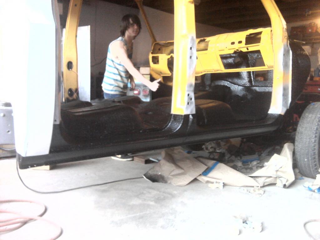

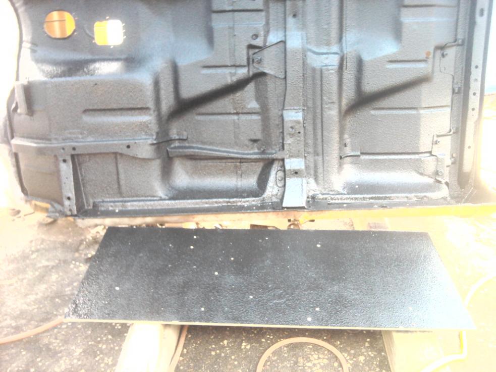

monstaliner is what I used
turned out great I sprayed it on check out my build thread the link at the bottom of my posts
I under coated my cab firewall and rockers and inside floorboard up the back of the cab and firewall
and I am putting dynamat on the firewall and front floor boards
monstaliner.com
I bought the undercoat gun on ebay for 30 bucks or so
