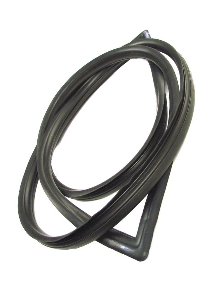

So is this a factory or aftermarket window? And the weatherstripping I was referring to are seen in the bottom of the slider. Replacements or can you fix? Hope I'm not high jacking.

That’s an aftermarket or Dealer installed Pass-Port (or similar) slider.
I don’t believe any of the seals are available. Probably have to improvise. The widow gasket is available because it’s the same one used for solid back glass.

I dont think mine is original though from your previous comments. So wouldn't that be the correct one I posted?
Yes, that’s the correct seal (WBL 1135) if you have solid back glass or an aftermarket slider with the flange on the frame.
I see your previous posted photo, so yes WBL 1135
