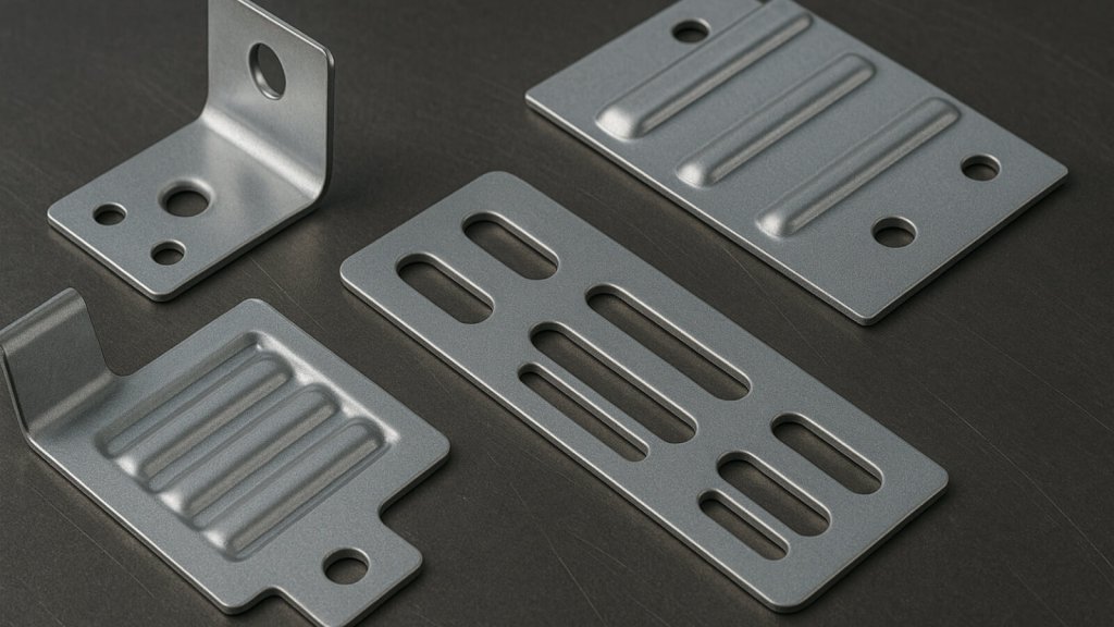

Looks a little rough. Cant see much in that pic, but what about reinforcing the frame?
Bolt and then weld on larger, longer, heavier duty versions of something like this:
