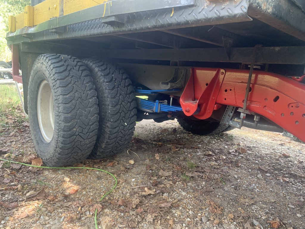

If you look closely, rather than boxing in, factory frame doubler lower section… Granted, this is where the factory boxed section goes to open rail on a gmt400 K3500 c&c… But (elephant sized but) no different than a lowrider on hydraulics running a “wrapped” frame. Unless you fully box, the standard sections become weak points where the frame twists even worse than it did stock. And boxed frames rot from the inside out, as evidenced by a 92 K1500 Z71 turned parts roach I have out back…
