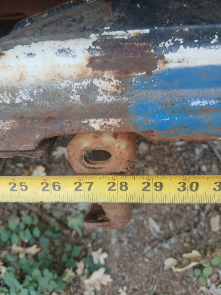

Thanks for the info guys! I guess what I’m looking for is the width between the frame rails the same? I have no problem drilling new holes or cutting and welding new brackets just don’t want to jimmy rig with spacers etc.

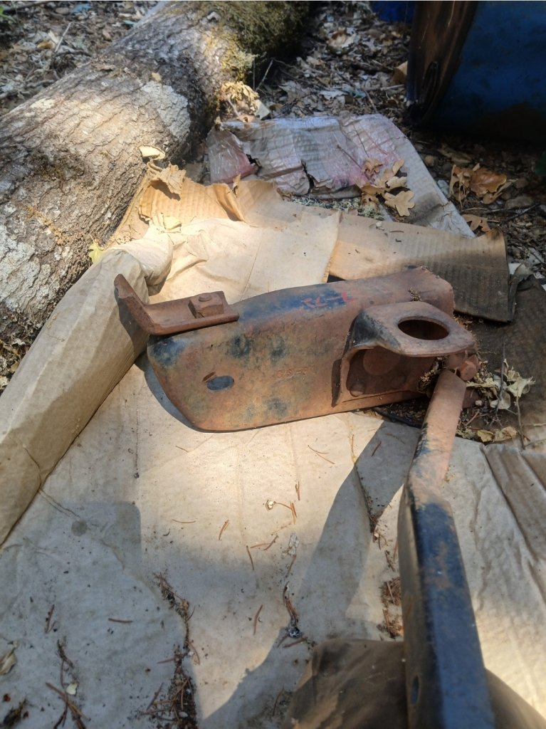

First picture of cutoff frame is 67-72
The other is a measurement of a 61 chevy frame. 28-1/2"

72? or 73? Either way, the frames are different, the '73 being less so. But it wouldn't be too hard to adapt, most of those offroad bumpers were and still are largely universal
