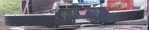

So after a Craigslist search I may have a line on a used winch bumper...the guy doesn't know what it came off of though..do were these made with vehicle specific bolt patterns to mount them up or did they have adapter brackets?? or ??

Warn built them vehicle specific. That pic has it on the tailgate of a dentside Ford so one might assume it came off a Ford...

Ford frame rails are a different spread than GM rails. however its not impossible to adapt it, one of my old friends ran a Ford Warn bumper on his K5
Got it!
Nice observation from a bad picture btw!

Ok…so the Craigslist bumper turned out to be a diamond plate backyard fab with no mounting brackets..
The more I look at what’s out there, the less impressed I am. The classic Warn bumper is probably the best thing I’ve seen so far.
I’m tempted to buy some 1/4” plate and fab one up, simple clean lines that flow with the front end and without some stupid a** logo branded on everything…I am so sick of everything being an advertisement

Ok...I think I may have found a bumper within a decent drive but had a question on mounting the winch...it looks like it's either a Warn or knock of type bumper but I was wondering if/how the HF ZXR 12000 winch will mount to it? From the dimensions it apprears as though the diagonal pieces attached to the front winch plate would interfere with the sides of the winch?

Those angle braces look like they will be in the way to me.

That was my thought as well…would it frowned upon to cut them out and weld in some corner gussets with cutouts to clear the sides of the winch?

It is YOUR Truck and it is YOUR bumper. Seems to me you can do whatever you like!
That front vertical plate isn't supporting the winch, it only holds the fairlead. There can be significant pressure on the fairlead if you have any side loading or the line is pointing up or down so that front plate has to be strong...but not nearly as strong as the base the winch is bolted to.
