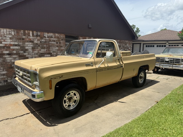

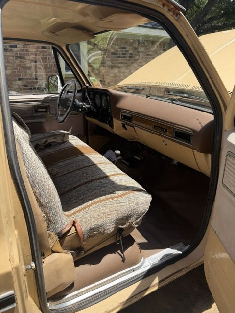

I didn't drive the truck much, and now that I think about it, I may have only been making sharper right hand turns on the route I took, LOL. I did mess with the transfer case lever and it feels extremely loose, possibly disconnected. When messing with the lever, the light for 4 Loc would come on, but like I said it didn't feel like it was actually changing anything, extremely sloppy. When I get back home from out of town, I am going to investigate further. Also attached a couple pics of the truck!
