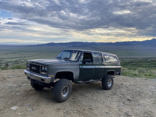

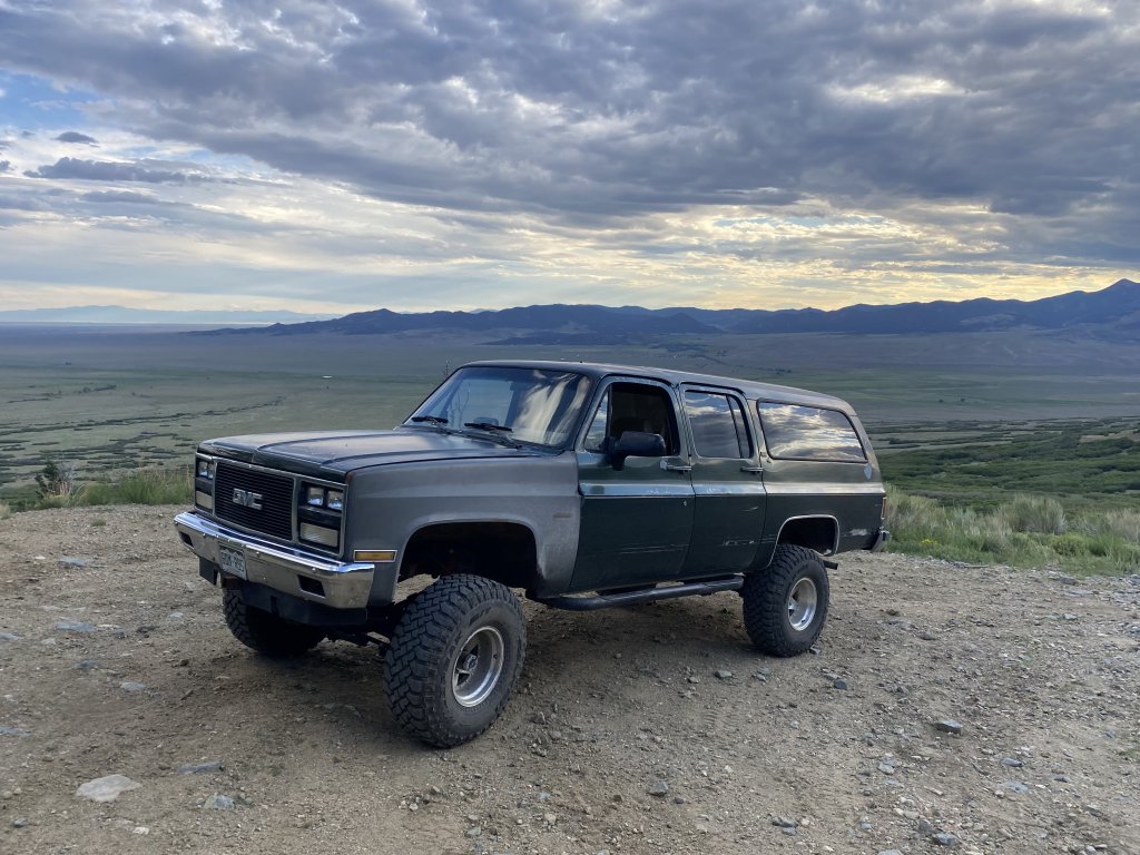

I've never had to deal with emissions testing before so any guidance will help. Also pics of the burb in case anyone was curious
