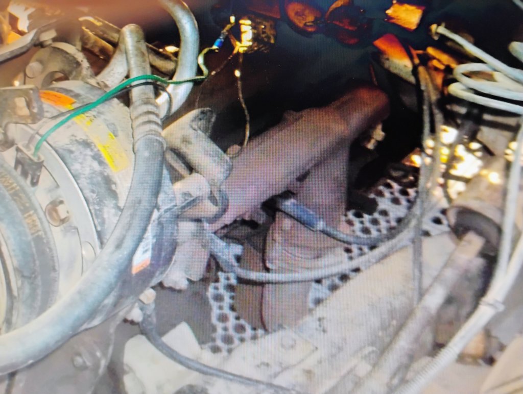

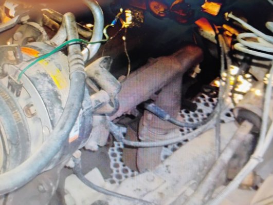

I doubt those plugs are factory, anybody that removed the tubes used those plugs in the holes. Post up some pics of your engine bay.
Here's some pics of the manifolds. Keep in mind, this isn't the factory engine. It's a crate motor that was put in before I bought the truck in 2019. Exhaust has been partially redone as the down tube on the driver's side isn't bent correctly so I can't use 2 of my gears in the TH400. Linkage hits and gets kicked into neutral so will get my new kit on eventually which is a complete dual setup I bought from Summit I believe.

It's not the engine that determines emissions, well, yes and no. If you installed a newer engine, chances are you would have to install and run the newer emissions equipment and pass the more stringent standards for that newer engine.
But, each state is different on that. Your engine being a crate engine replacement, I doubt they get into all of that, as you're running the "original" equipment on the engine. Except, you're lacking "original" equipment on the engine.
It previously being a farm truck, the PO could get away with removing all of that equipment. Now, you will be registering it and using it in a more typical fashion, so the emissions equipment, whatever was there originally, will need to be there to pass.
I would bet money that besides the egr you removed, your engine came with the smog pump, the spaghetti of vacuum hoses, and the tubes on the exhaust manifolds. As stated by others, you do need to research to find out what it came with. Post up pics of the other side of the engine and the SPID label in the glove box if it's still there.

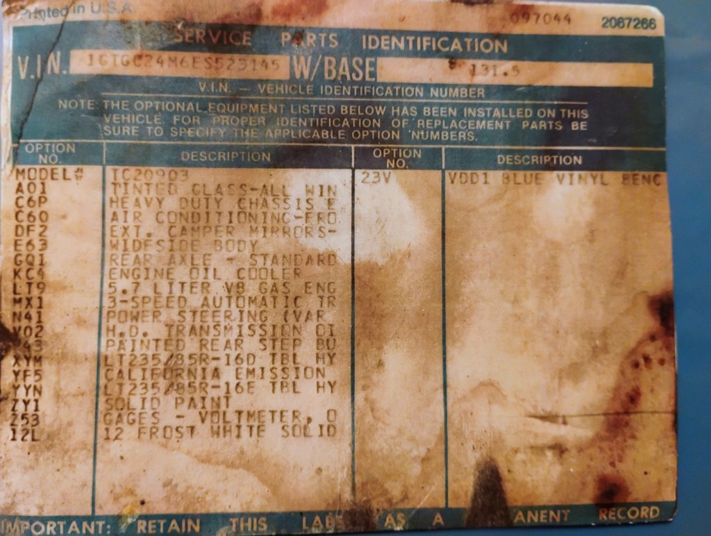

Here's the SPID. sorry it's not very clear. It was on the left inner fender. Anyways, who or where do I check with to find out if it came with all the emissions garbage?
I did notice it says YF5 California Emission, so that answers that question
YF5 is it. You somehow need to find what YF5 truck's came with. Maybe @Keith Seymore knows where to look for that stuff? There was another member on here that needed the stickers on the air cleaner because the truck wouldn't pass without the stickers. That was lame, but I think he found them.
