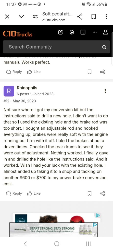

When I converted to power brakes, granted it was on a 65 C20, I had to drill a new hole in the brake pedal to relocate the rod, and the new rod had adjustments to get the pedal right.

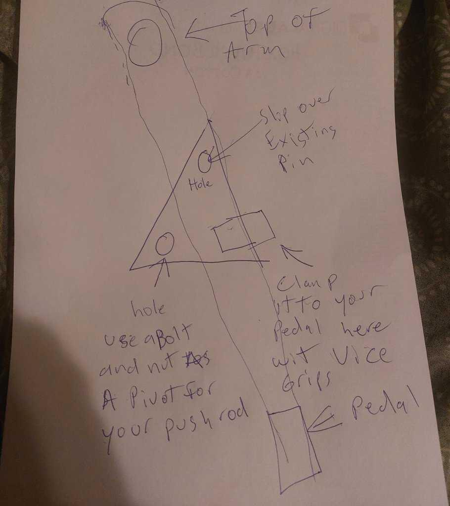

Let's save some time,don't pull the master yet. I have a giant suspicion that the pedal ratio is wrong and not moving the booster enough,in turn not moving the master enough. Cut a Triangle out of a scrap of steel plate drill 2 holes in the plate,1 for your original pivot location at 1 corner of the traiangle,1 forward and down an inch,this will be the new pivot location,use a bolt and nut as your pivot pin for now. Clamp the bottom of the Triangle to your brake pedal,see if this fixes your problem,if so make a better bracket and weld it to the pedal or drill the pedal.If you try this first you won't have to pull the master or bleed the brakes again. I've put a pic for illustration see the kid in red pants his but is going to go higher and lower than his knees when the teeter totter goes up and down. Why? Because his but is further from the pivot point. Moving the stud for the pushrod further from the pivot point is going to move the pushrod more and more fluid will move with the same pedal motion. I also use teeter totters to explain valvetrain geometry,suspension geometry and bump steer.

Stupid question….if I remove the master from the booster and measure how much the push rod currently comes out of the booster when the pedal is depressed, wouldn’t that tell me if I have enought travel on the master side?
Can you give me a rough sketch of what I am trying to do if I send a pic of my current setup tonight?

Don't have time to sketch it quick cheater method of what you are trying to do to check clearance pull the master forward put a piece of clay between the pushrod and master tighten up the master then Loosen check the thickness of the clay.There are 2 other ways I know but both involve 2 people and involve more of an interpretation,so harder to be accurate. Also heard of people putting toothpaste on the pushrod,tighten the master see if there's toothpaste on the inside of the master.it needs to be a thin blob. As for depressing the pedal without the master in place I would not do that,I have heard you can damage the booster. All boosters are not the same and this is just general knowledge. Some GM boosters have a reaction disc in them that can fall out,or be left out on assembly and they are not all a captured design,but if the reaction disc is missing you will have excess clearance between the booster pushrod and the master. If I had to bet you money,and if we were in person I would bet you 100.00 that changing the pushrod location fixes your problem. It's geometry,move the pin location makes the lever longer,the travel on the pushrod increases,the pedal moves the master further,displacing more fluid and increasing brake pressure. What diameter master are you running? A larger master would also displace more fluid. I am assuming you adjusted the brake pedal pushrod when you assembled everything.

You don't need to match a hydroboost car,you need to match a vacuum car. Or just make a temporary relocation bracket and verify. But I guarantee you that's the problem. Does the top the middle or the bottom of your pedal arm move more???? That's what I'm telling you move the pushrod lower on the arm and it will move more. Just kidding you really just need to bleed the brakes again and change the wiper blades

I did not know this was a conversion from manual brakes to booster brakes. Other parts may be needed.
Did you add the firewall bracket that a power brake truck would have? Some manual brake trucks have the master cylinder bolted right to the firewall, no bracket. Different years had different bracket off sets.

I'm home now,I drew you a sketch slip your bracket over the existing pin and clamp it to your pedal. Than post back telling us your problem is fixed. Then redrill the pedal or weld on the bracket. Nothing is to scale just giving you the visual.
