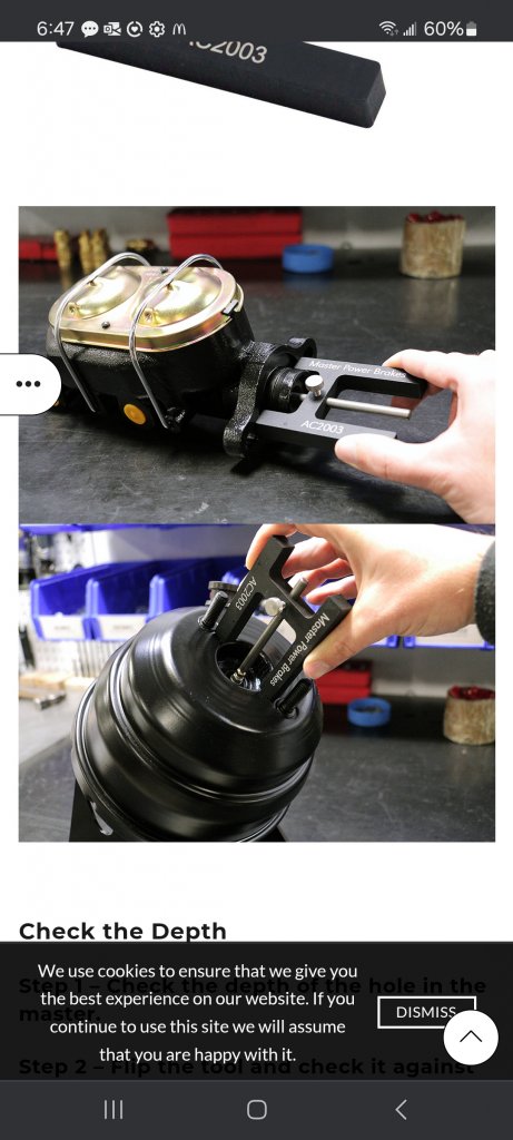

Did you adjust the brake booster pushrod properly? Not the rod from the pedal to the master,the one in the booster that pushes on the master?Was this a power brake car to begin with or is this add on. If added on have you changed the brake pushrod pivot location accordingly? No vacuum or a ruptured diaphragm causes a rock hard pedal not a soft pedal.

There is a hole in the master cylinder,sometimes there is spacer in that hole also. The brake booster has a pushrod that fits in that hole,and that pushrod is what actually moves the master. You should have .020 clearance between the pushrod and bottom of the hole or the spacer on the master. If the stick out on the booster isn't enough the pedal moves,the pedal pushrod moves,the booster gets moved but the Plunger moves inside the mastercylinder bore,instead of moving the Plunger. Also if the brake pedal pushrod is too short it won't move the booster enough. And also if the brake pushrod is in the wrong location on the pedal it may not move the booster enough. Many vehicles use a different pushrod location depending on whether or not you have power brakes. If you switched from manual to power you may need to relocate the pushrod. Now all three of these may be wrong or even just two of them,and the tolerance stack is keeping you from having a pedal. I can teach how to check the clearance,without special tools,if you haven't already done it. Actually so can @fast 99 .
