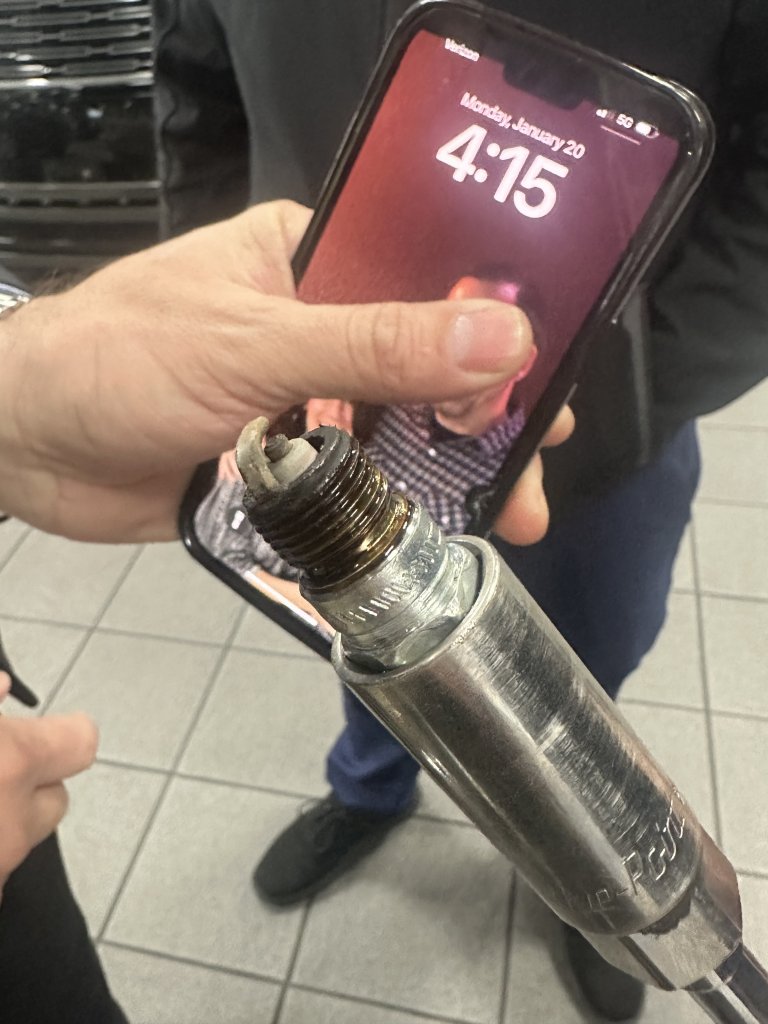

Is it possible to burn it but not see it? It does have a burning oil smell but no smoke. I’m assuming it would be blowing tons and tons of blue smoke if it was eating oil.
This is what the plugs look like:
Hmmm... interesting that there is no carbon buildup on the plug itself. There is a lot of oil on those threads though. How many miles do you have on the build now? As others have said, I'd be running it hard at this point to try and seat the rings. Medium to heavy throttle up to ~5k rpm and then let it decelerate under load to ~15mph. Repeat a few times and then let cool. I would say to start with let rpm and light to medium throttle, but it sounds like you have already been driving it for a while.
