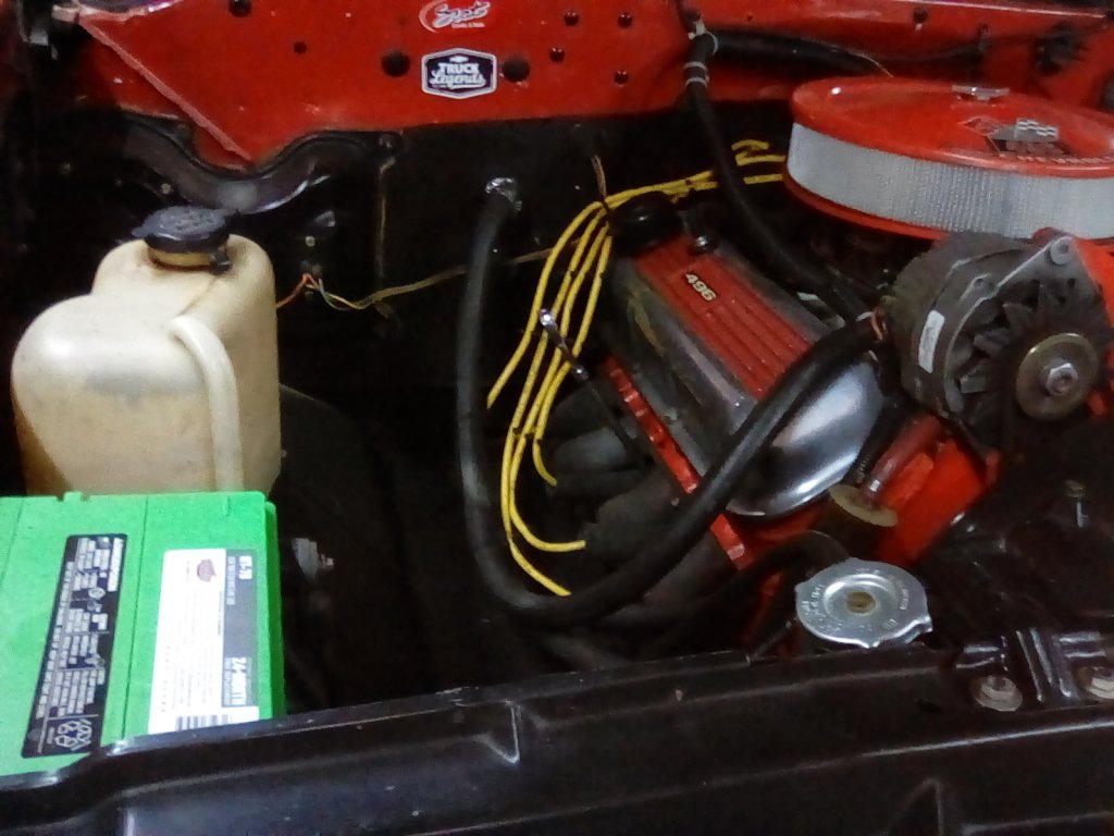

I used Shaeffer 7000 Supreme 10w40 high zinc oil on break in on my flat tappet 496. still using same oil 11 years later, motor happy.
