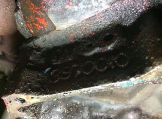

[Can someone also help identify my motor, i know its a 350 but my truck is a 76 and ive heard the motor is from an 84, i have some pics to upload for you guys
The top may be hard to read but behind the valve cover on drivers side states:
GM3970010
ATTACH]34411[/ATTACH]

Nice! 010 is a 350. Not a Mexican block...
Look on the driver side , under the manifold, near the oil filter housing for more markings but to detail the year, there is a pad below the cylinder head (front) passenger side. Prolly have to remove your alternator to get a good look at the SUFFIX CODES.
Good job on the pics, keep em coming! "Go advanced" and upload using the paperclip. May be easier.
Pull the easy valvecover to ID the cylinder heads!
