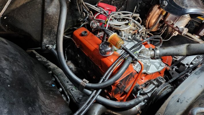

Putting the number 5 bolts in on this set of headers, sucks.
Watching and day dreaming about the new noise...

Putting plug wires on #5 sucks as well...
So cute and suckass for any kind of power.
This should do for any level of power he puts in the engine bay.
