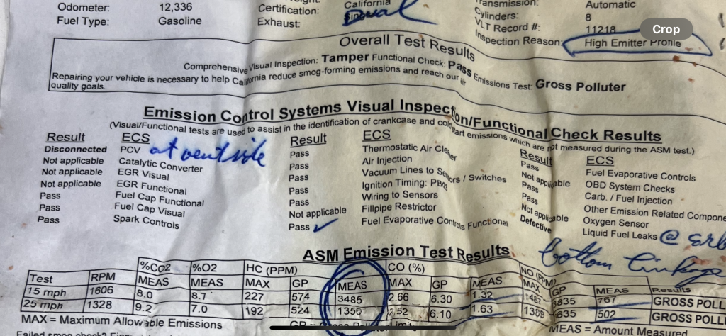

Passing CA Smog help - High HCs

Does California do under hood inspections? They did them here. Vehicles would fail for simple items like a missing air cleaner hot air tube. They would not even test the vehicle if anything was missing, altered or if they could prove it inoperable. 2WD FWD were dyno tested, 4x4's stationary.

Here’s a list of what they were looking for in the visual inspection.

Sure do

Wow, those HC's are way too high! I need to dig out mine from the last test to see where it was on the failed test and where it was after the retest that passed. I replaced the carburetor to get it to pass last year.
Yeah I swapped out the Qjet for eddy 1400 (working on figuring vacuum lines), replaced pcv valve, plugs and wires changed, replaced the air filter. Next is oil change and fuel additive.

I hope it all works out for you, from what I've heard it can be a pain to get the half tons to pass. Luckily yours is the heavy half and didn't come with some of the bs that makes it nearly impossible nowadays for them to pass.
