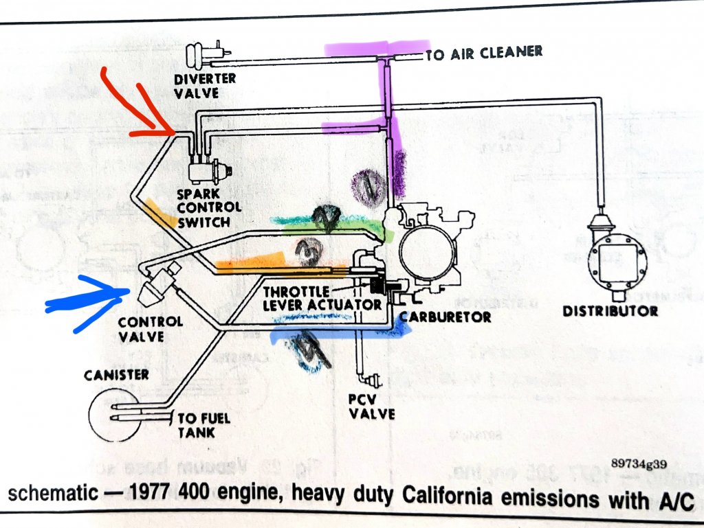

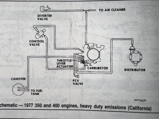

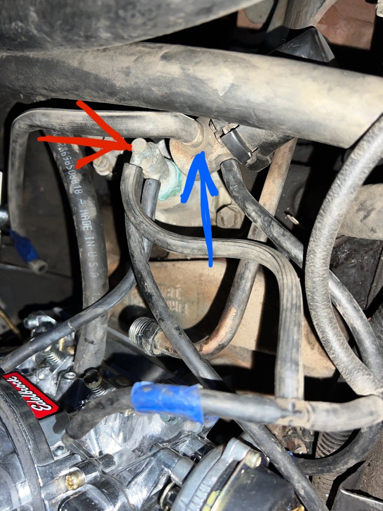

I am swapping out the the 4MV Qjet for the Edelbrock 1400 and need help with th vacuum lines. Pic 1 is what the set up should look like. Pic 2 is the current setup with the Qjet. The PCV and canister have dedicate connections to the carb. There are two remaining ports available on the Edelbrock, 1 manifold and 1 times/ported. If I keep the current configuration, what goes where? I color coated and numbered the vacuum lines I’m unsure of. Number one goal is to pass smog test. I will address power and fuel efficiency once smog is taken care of. I’m adding a 3rd pic of what I believe is the ‘spark control switch’ (red arrow) and ‘control valve’ (blue arrow) in case I am wrong (maybe it’s EFE?). What is the best configuration to pass smog? Note- heavy duty did not have EGR systems or Cats. If it doesn’t smog after this, I will take the advice in a different thread and put on a couple cats (dual exhaust) - the truck needs headers anyways. Thanks in advance

It looks like your Quadrajet must be set up like my original ‘75 carburetor, where there is a dedicated port for the vacuum canister. When I swapped to a 1980+ Quadrajet it did not have that port.
I have not been able to find an original vacuum diagram for my ‘75 350 with HD emissions. I’ve also never figured out exactly how the original vent control for the canister works, since there is no separate purge valve. I’m also not sure if it’s function might be related to your high HC levels.
I T’d into the PCV line and connected the canister vent there. It seems to work, but probably creates a vacuum leak at idle. However, I can still get the idle mixture set without any issue.

I believe the blue to green line in the original diagram I posted above - the vacuum circuit that goes through the control valve, has a function in the choke. Since the Edelbrock has an electric choke, I dont think I need this. Is that correct?

Vacuum lines actually weren’t that complicated. The ‘control valve’ was required for the quadrant function but not for the Edelbrock. Yellow line went in to manifold and purple into ported/timed. Seems good. Few hiccups along the way but testing tomorrow.
