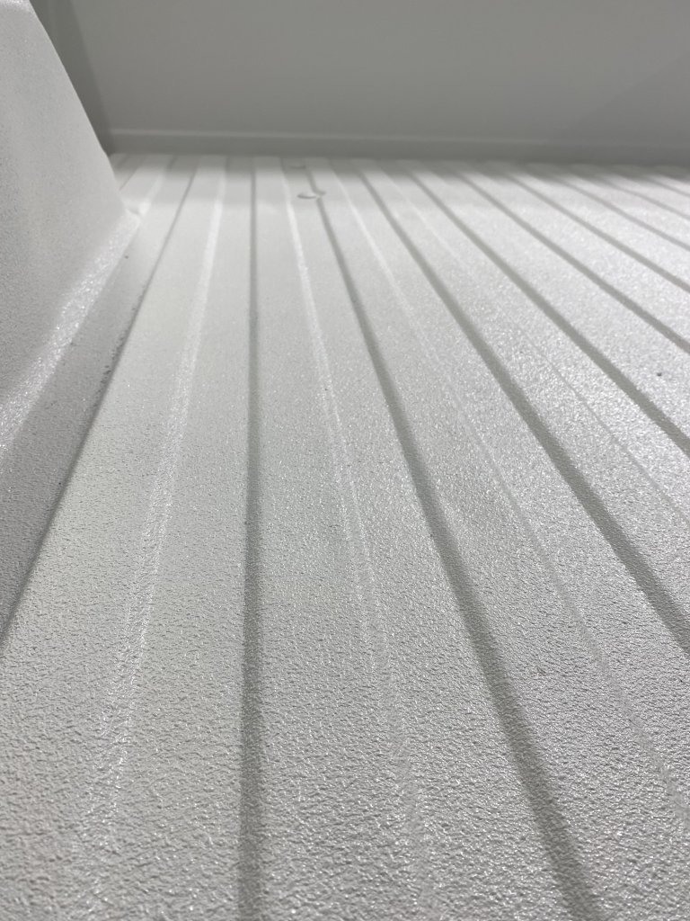

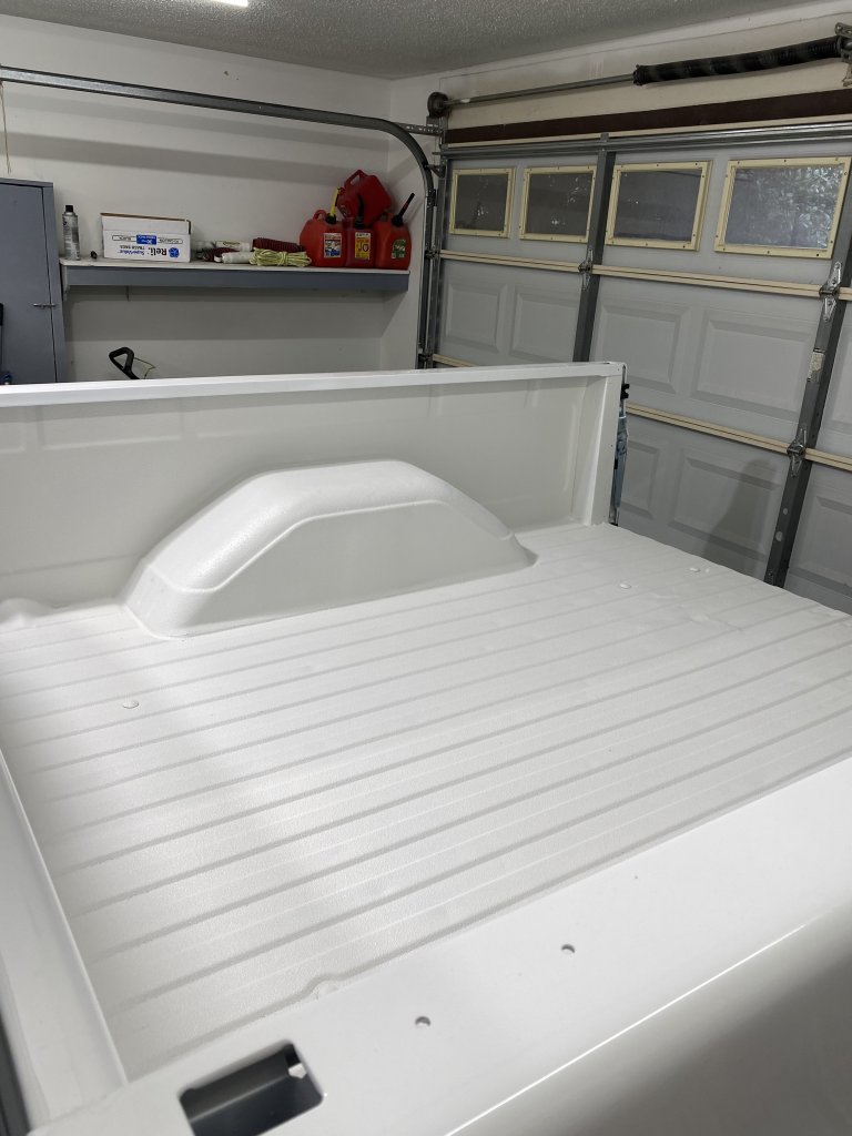

@Grit dog Raptor liner has tintable bed liner. I sprayed mine white. Came out great but don’t know durability yet.

Yea I'm gonna sand mine down and rhino liner it. Use it and repeat if necessary!
