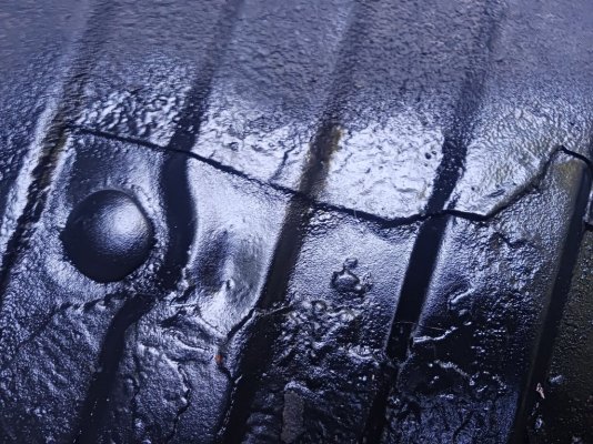

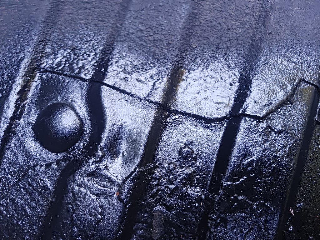

Ok guys I got the stuff in. Bed liner Pro by TCP is the product and it comes in a spray can. Wholesale price was $18 a can and I bought two. At that price if this is a total failure then it's not a huge loss. So I test fired it on a scrap of metal.
I'm happy to report that it does not have the awful sharp up raised texture like some DIY bed liner stuff has. Actually it looks a lot like the stuff currently in my bed, but of course it's much thinner. Obviously I can't tell how it maintains pliability down the road.
I intentionally took pretty close pictures so you can see the grain of the "texture".
First coat, those artifacts in the upper left corner were on the metal before spraying, so that's not a good representation of how it came out of the can, but does show that this stuff will not cover flaws well.
And after the second coat:
That flawed area is more in the middle of the second coat and you can see it's much less noticeable. The grain or texture is about the same in the second coat but these are all inside the shop photos and the lighting sucks.
I'm going to go over all the areas of the bed after work that have missing liner. Let it dry overnight and then decide if I need to hit those areas again or roll the entire floor of bed out.

Well I applied a couple of coats to the areas that the old liner was torn up. I'm not really ecstatic about how it appears. The main thing is it would take a LOT of repeated coats to build up to the level of the pro liner. However this stuff is bonding to the pro liner like crazy so that's a good thing. So I don't think I can get away with covering the entire floor and letting it rip. I think because of the height difference between the two liners, it would be to easy for the higher one to be torn up, if I'm having something shoved in the bed like a pallet.
@Camar068 it's much thinner than a pro bedliner and it has even less texture than mine does. So whatever gripping it does is going to be from it's compound.
I would never apply it to bed that hadn't been linered already, unless it was all scratched to helll and I was to cheap to buy a drop in. I like it better than other aerosol bedliners but I still don't like the product in general.
Pictures:
So that's what we have. It's sealed, and I can always shoot a little more on tomorrow to be sure it's got a good water tight seal, but something absolutely has to go on top of it ASAP. I will let you all know what avenue I take.
