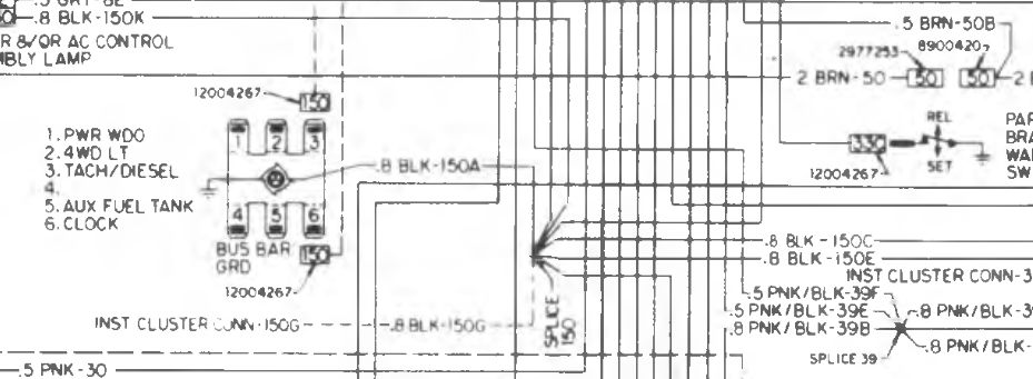

Check the grounds- there is a ground bus bar over by the emergency brake on the kick panel- I think on an 82 it will be behind the left lower a/c vent on the kick panel. Make sure it is making good contact and the black wires are plugged into it securely. Also- just in case- your pull knob for headlights rotates to brighten & dim dash lights- make sure it's not turned down. I will also mention- if you are using LEDs they might be in backwards (rotate them 180 degrees)- some LEDs are polarized-electricity has to flow through them in a certain direction.

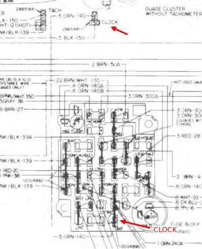

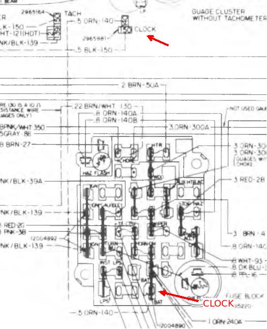

Clock usually will be plugged into fuse block in front in a batt slot. -see attachment

If you don't see a spot at the heater controls for that, it goes to the ash tray. My wiring diagram shows a 4 place plug with gray, yellow and black wires labeled radio power.
