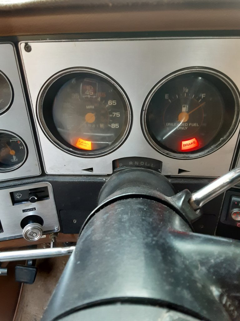

I’m getting so frustrated and at a loss trying to figure out this dash issue. No blown fuses. All new bulbs, sockets and printed circuit. No lights work except my right turn signal. All lights work as they should on the outside but nothing on the inside. And I can’t figure out where the clock plugs into on the fuse box.

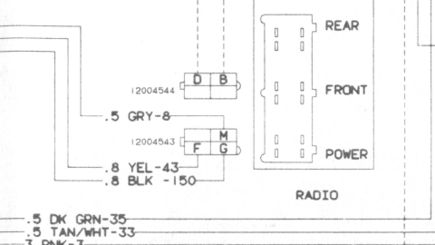

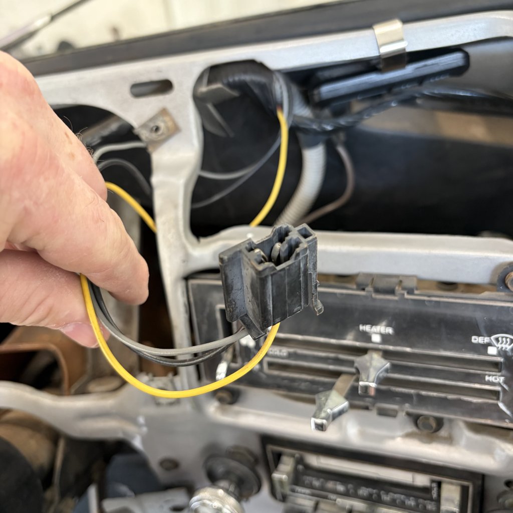

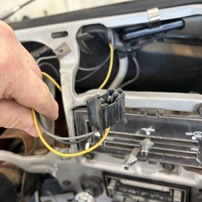

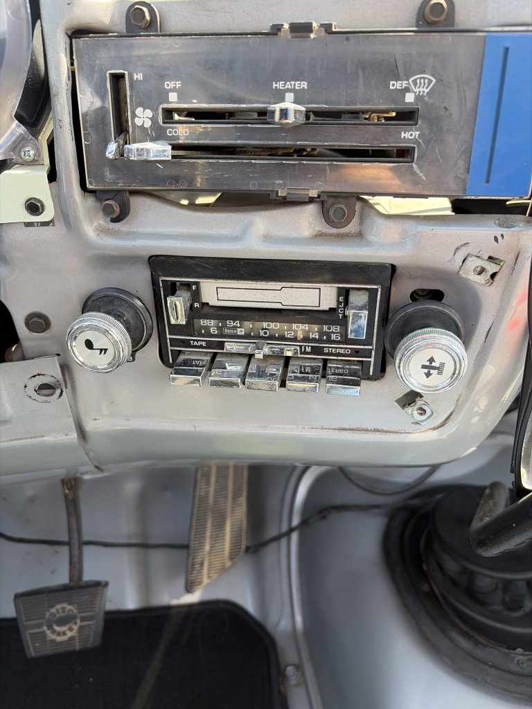

If you don't see a spot at the heater controls for that, it goes to the ash tray. My wiring diagram shows a 4 place plug with gray, yellow and black wires labeled radio power.
