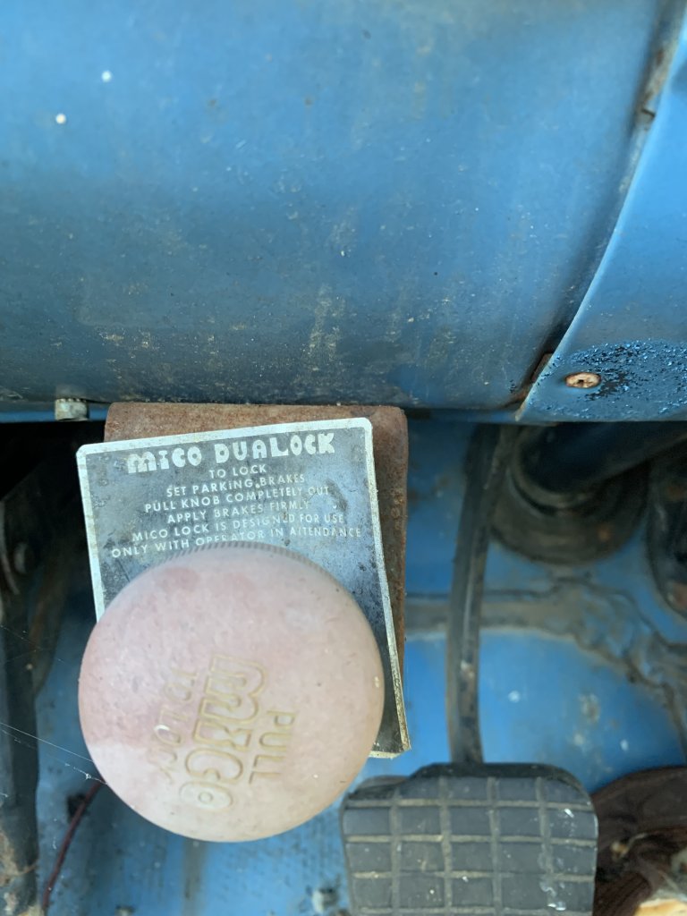

It’s a retired utility company lineman’s truck. Set parking brake. Set line lock. Put in neutral, engage pto, operate the bucket lift boom. It applies the front brakes as well as the parking brakes.

Will likely add it to my gmt400 K3500 c&c dually for heavy winching. Selective cutting hardwoods that require winching to retrieve logs for milling on the farm.

shouldnt it have those arms that stabalize into the ground kinda like a fire truck?
Still not understanding why it would be needed to "lock" the front and rear brakes hydraulically with a parking brake. Maybe im not understanding something?
