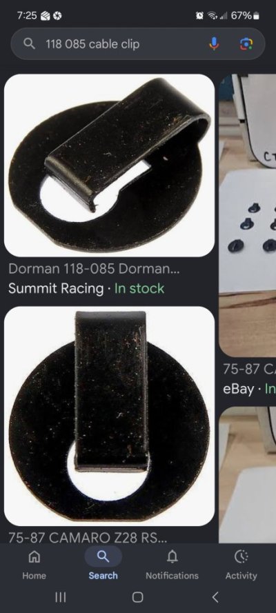

Does anyone know if the TV cable retainer clip is still available? O'Reilly and Auto Zone did not have anything close. I believe the same clip is used to attach the accelerator cable to the carb. I may have blown the thing off with a blast of compressed air while blowing out the engine bay since it wasn't laying on the intake manifold. I have a piece of wire wrapped around the groove in the shaft but I don't feel comfortable with that.

TV cable clip is built on to the cable. IDK what you are dealing with.

Rick, that Dorman clip is exactly what I need. My accelerator cable is retained on the carb shaft with that clip the same way as the TV cable. I'll order a few from Summit. Thanks

Auveco throttle clip. Part No. 15459 SKU 15459
Box of 50... share with friends. CLICK HERE
GM part No. 1247872, 15567924
