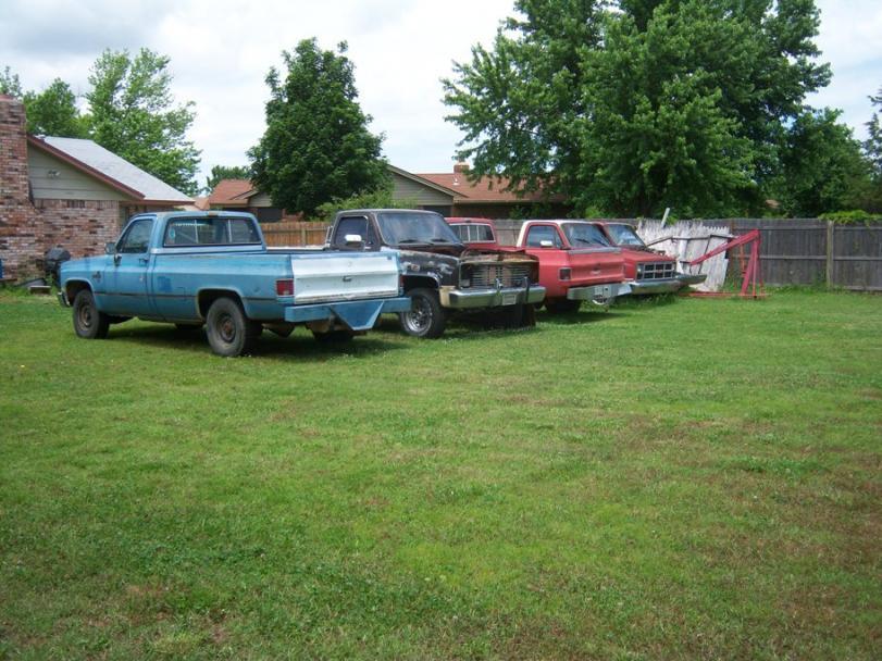

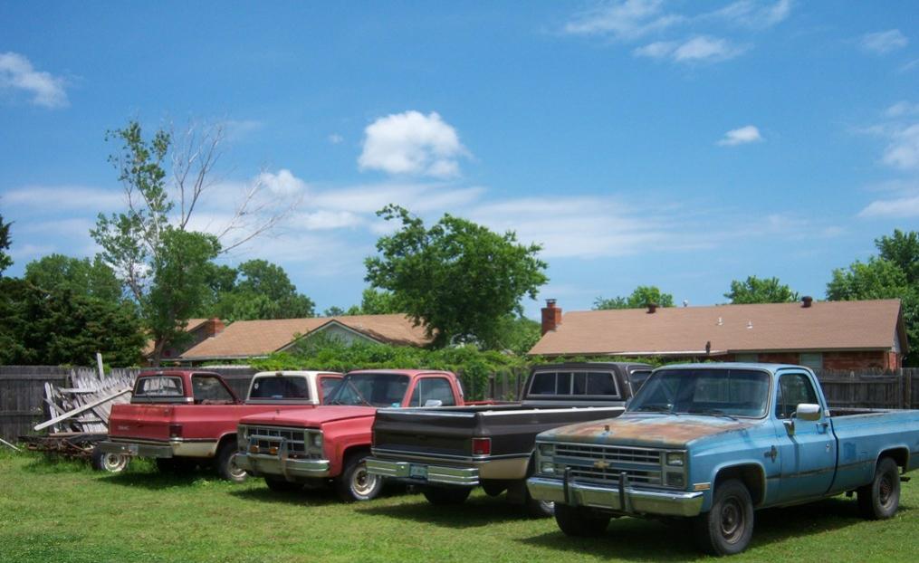

Ahh that sucks not to have a cam. Did it kinda get you stiff in the pants??? LMAO I wanted to get all mine in my backyard and take a pic one day. But, the other 3 were at another location, and I didn't have the Burb yet. So I only got pics of 5 of them. 2 of these trucks pictured here I don't have any more. The one without the bed is the one I sold every single piece of it with exception of the block that had rods hanging out of it. Sold the heads and the rest of the engine though. Then the red 80 GMC with the bull bar is the one I recently parted out and scrapped the body cuz it had more rust than I wanted to deal with. Although, it wasn't real bad, it was bad enough when I come across fairly rust free trucks somewhat often. Normally if they aren't 90% rust free or better, I won't buy them and even at that, it better be pretty cheap otherwise I prefer the 98% rust free trucks which most of mine are.

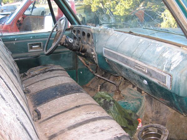

What you need is a truck your like your little bro. Have both SM465 and an Automatic. That SM465 starts acting up, just put the SM465 in Nuetral, then shfit in D and run the automatic. LOL, That is so damn cool. I like it so much, I am gonna take my shifter stick out of my SM465 sitting in the shop, and I'm gonna mount it in the hump of my truck.
