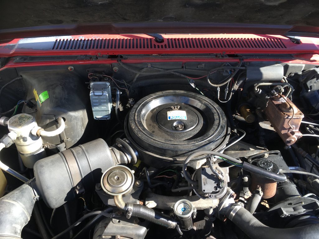

I am convinced that this truck has passed the reliability test. I drive it everywhere, handles and steers great with the new tires and alignment, it was out a bunch, back as well. It starts every time with the manual glow plug mod. It is cool, there for I to am cool by association, gotta developed that sneer for lesser rides, and she's purdy. Also I used to hate the 6.2, but I have had to learn about it and have a pretty good feel for it now. It seems to me with the 32' tires, 1:1 trans and 4:10 gears that between 55 and 65 is a good rpm. Actually 62 sounds best. 3600 is max rpm, so with 4.10 gears, 31.7 tall tires and a speed of 62, my rpm is 2811. When I get the over drive trans, (700r4, or 4l80e?) at 75 rpm's will be 2343. Going through parts of Idaho, Nevada speed limits are 85, so at that speed the rpm will be 2655. That is the same as the 3.075 rear end, interesting stuff. Oh yeah torque at 240@ 2000 rpm's, peak torque 275@2750, so in the ball park.

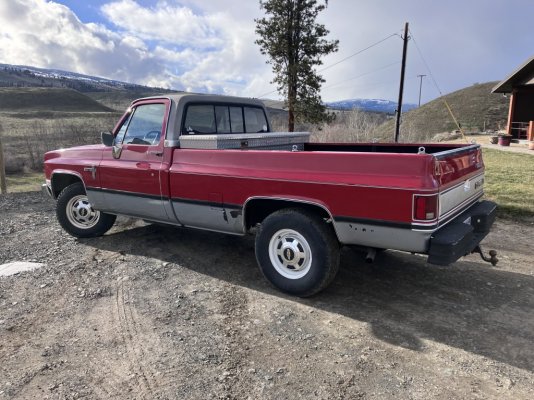

Went to the Dr, and when I came out, truck wouldn't start. Luckily a fellow farmer saw my dilemma, had cables and got it started, God bless him. Sooo bought two new red top odyssey batteries, and man what a difference. Yes still have to use the glow plugs, but parked for ten minutes at the store, and came out and started without using the glow plugs, first time ever. Hope they last awhile...

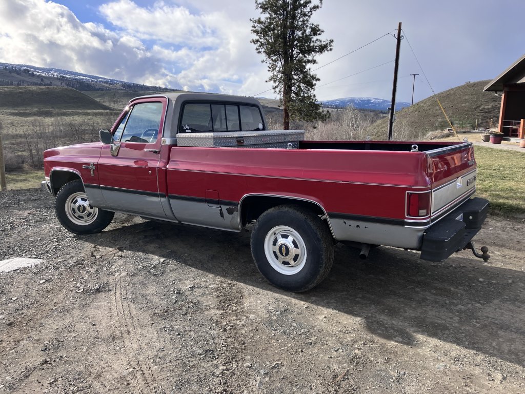

I am considering swapping engines with the K20. The 6.2 D Diesel is just a gem, and if I put this into the K20, I would have, in my opinion, the ultimate practical truck for where I live. I would reseal the engine, remove all the diesel wiring from the harness, (I will probably remove the whole harness and transferer this complete to the K20. Since the K20 dash does not have any "water in fuel", and "Glow plug" provision, I will come up with sone way to incorporate that into my dash. With the 4l80e trans I had planned to swap into this truck bolted to the 6.2, (direct swap except it is about two inches longer,) a US shift fast four controller, I could cruse at 70+ and get 23 or maybe more mpg. So anyway I think that is the direction I am going with this. I will also post this on my K20 build.

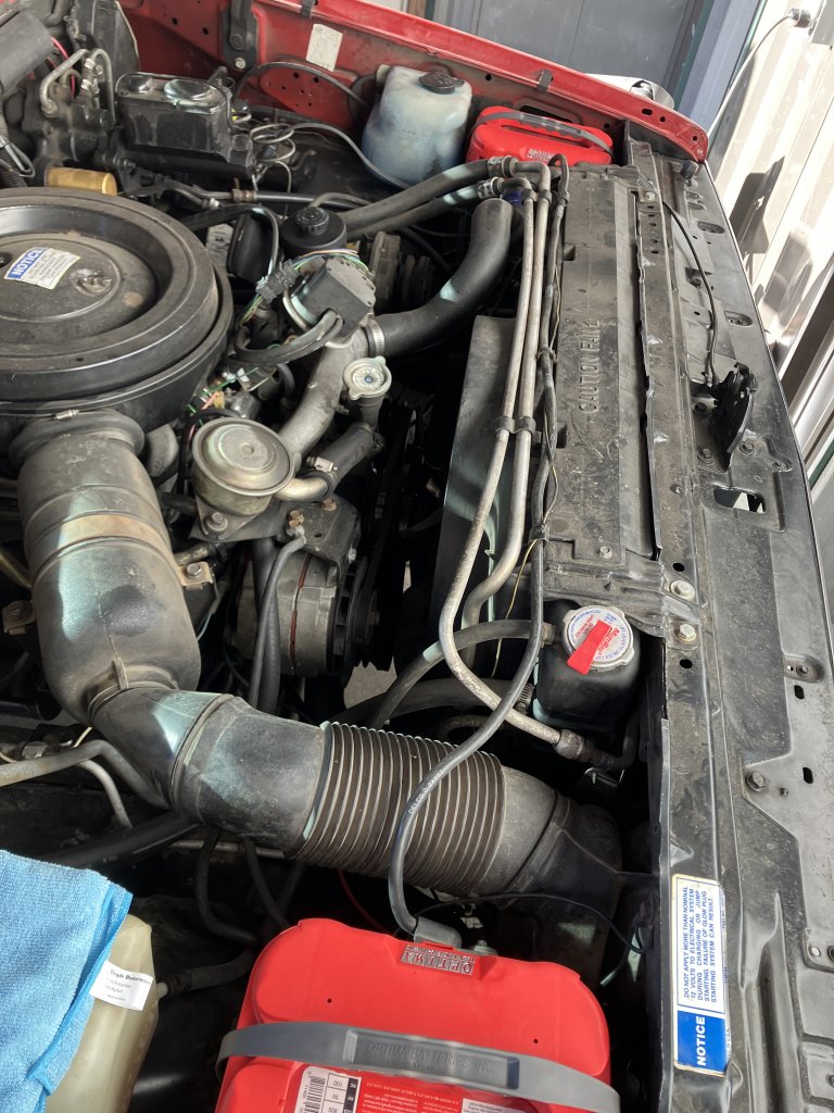

As some know, I am hooked on the salt, and want to run another rig down there, and this truck would be a great candidate. Huge engine bay, 14 semi Floater with 4:11, (will change the rear gears,) with a 4l80e trans should get me into the 130 mph club, and a good place to start. While I have never lowered a truck, thinking of installing a handling package front and rear, so it handles really good, and less air underneath. I will install a adjustable front dam, and do not know if I can do all those projects, so will start with the drive train and get that installed right and tight. Will for sure remove the front end and clean and paint something like what I did earlier with the bed and back frame, probably the cab to finish the underneath stuff. Not looking for perfection, but protection, salt is corrosive.
