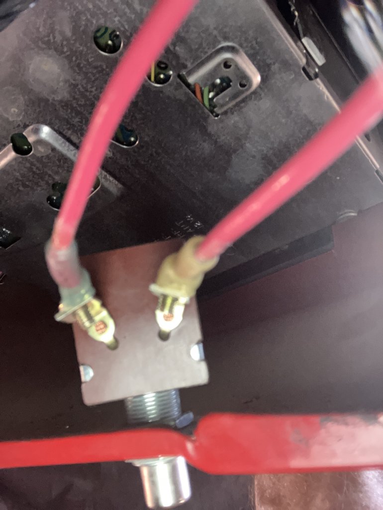

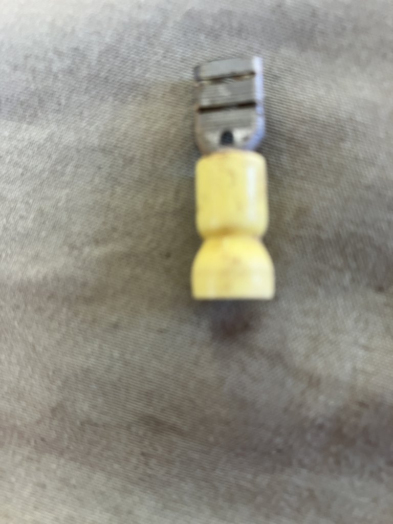

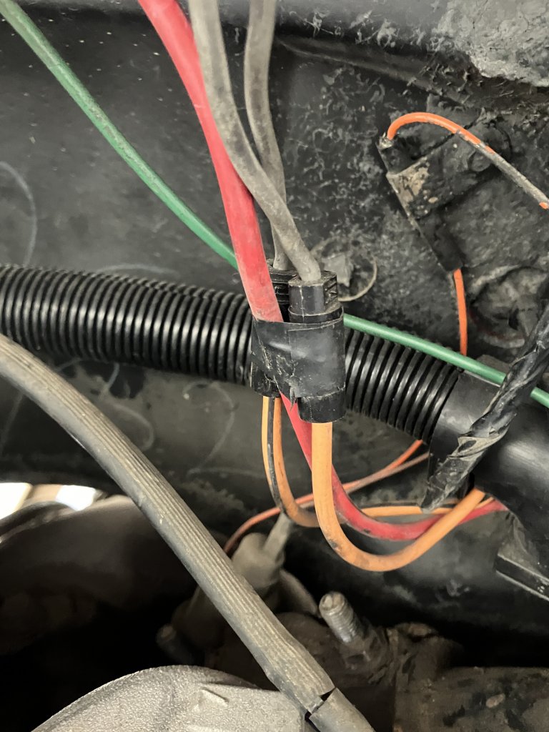

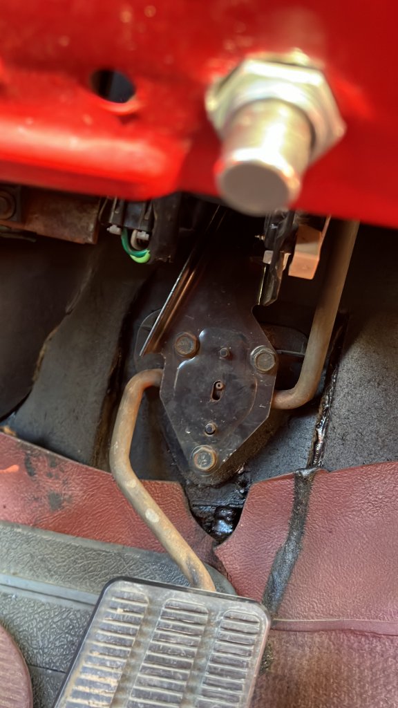

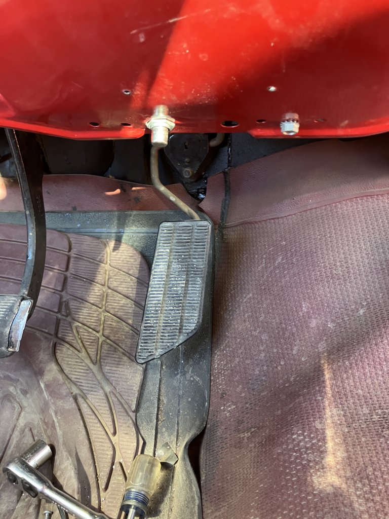

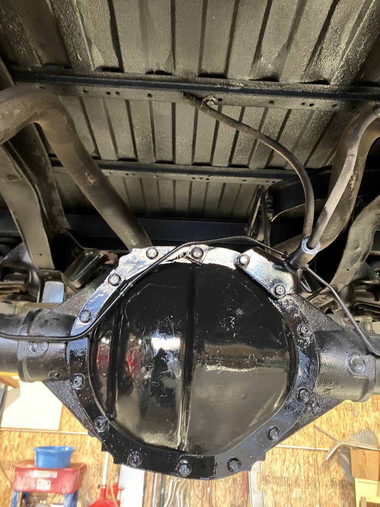

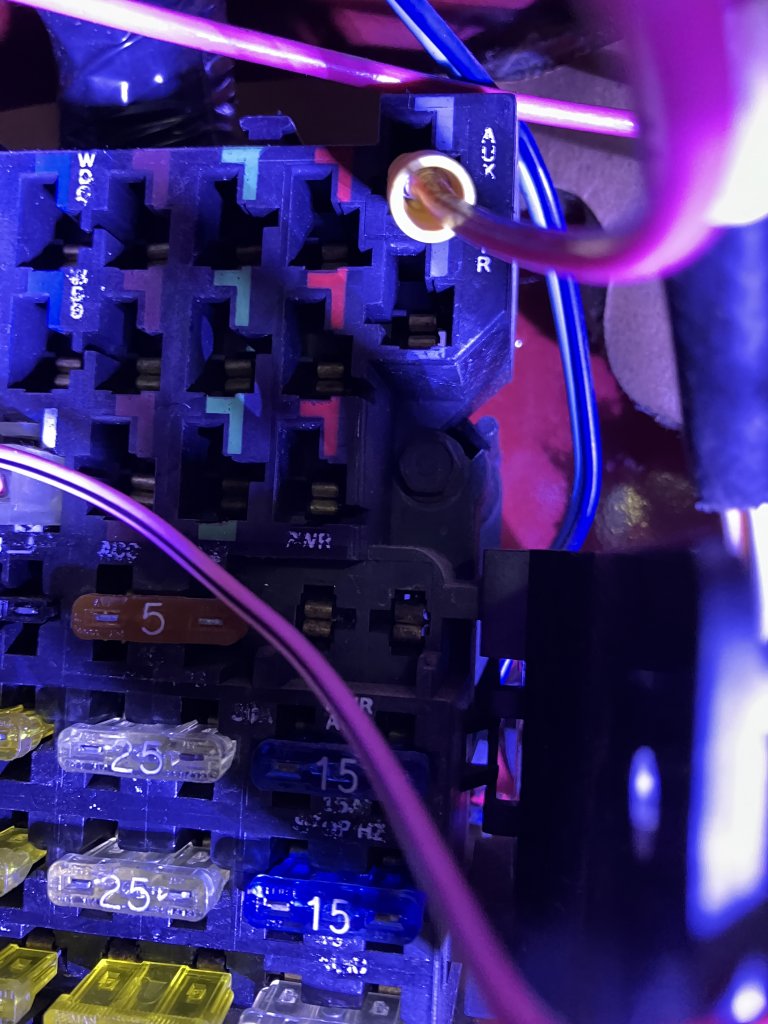

As promised Manual glow plug parts and instillation for 1985-90's diesels. Parts used, push button switch, solenoid, 1/4 spade. mounted switch where there was an existing 1/2 inch hole, but had to open it up to 5/8 using a stepped bit. Once the location was determined, using a sharp 1/8 ex screwdriver, pushed a hole through from the engine side as easier to get to. Used 14ga wire, pushed it through the mastic and into the cab. This wire will eventually go to the solenoid from either terminal on the switch. Attached another 14ga red wire to the 1/4 spade, which will go on the top right side of the fuse box to the AUX slot, which has current with key on only.

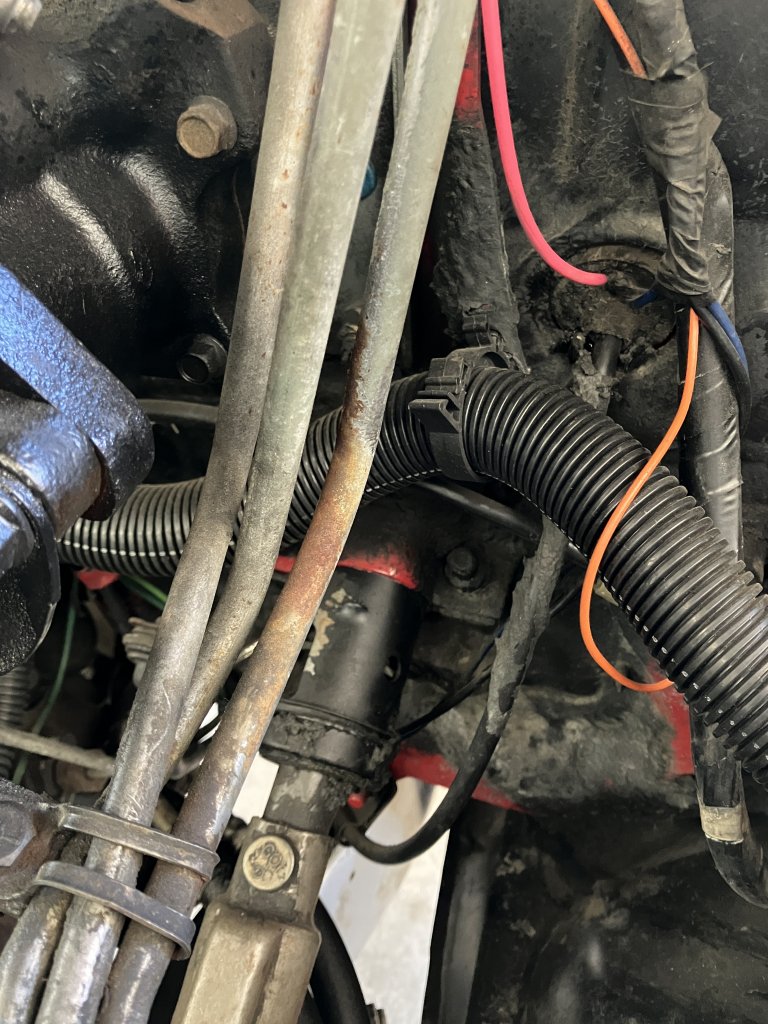

The keyed power from the fuse box is attached to the other switch terminal. I routed the wires over the brake assembly to keep the wires out of sight, and for protection. checked the switch for power B-4 proceeding to the engine compartment.

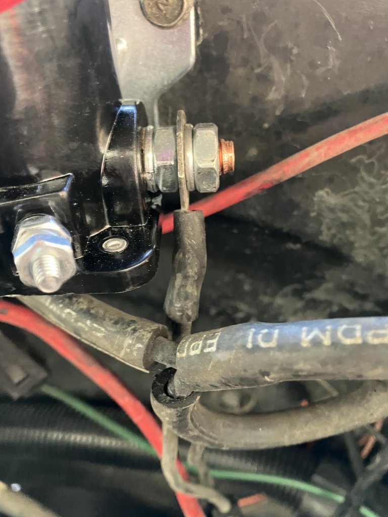

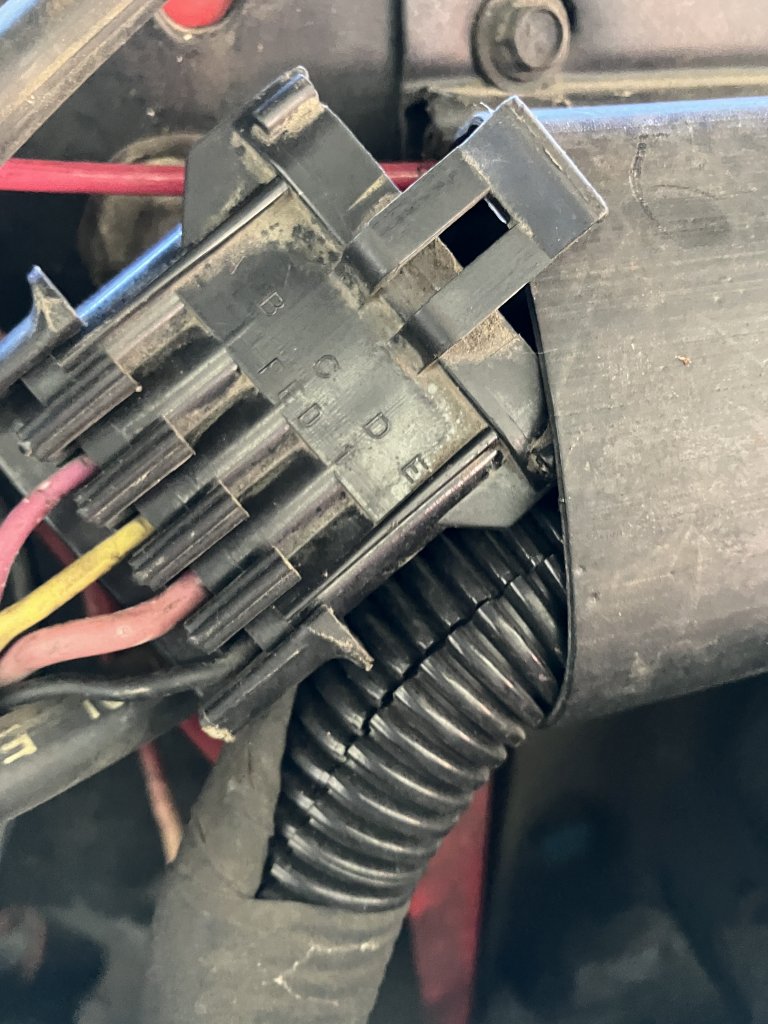

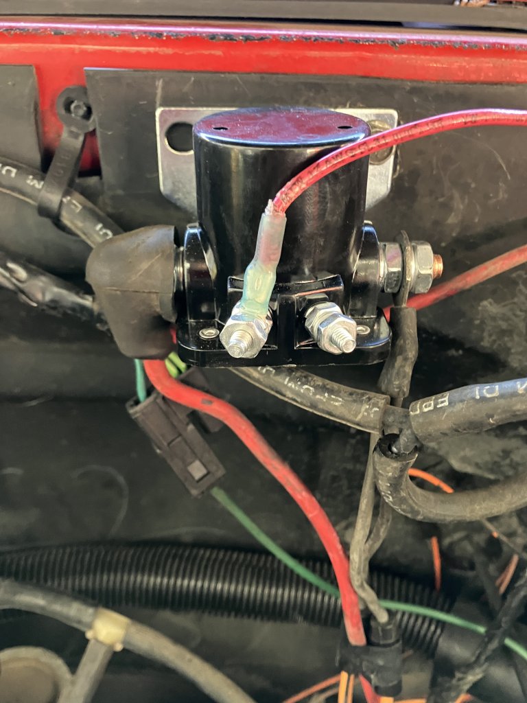

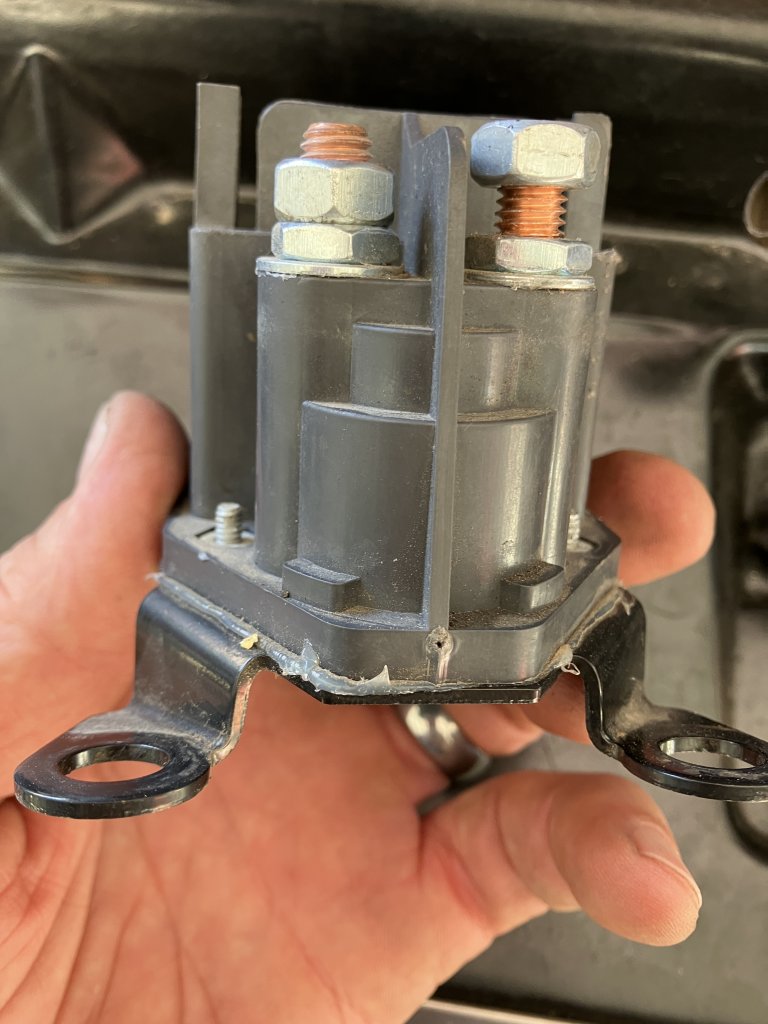

I mounted the solenoid here as there was already a bolt there, just bolted it down. Remove the two bolts holding the original glow plug controller, (unhook battery terminals first from both pos side of the batt, and neg of main battery.) Remove all wires from controller and set the controller aside, it will not be used. Power from batt on big left terminal. power to L&R bank glow plugs on right terminal. On my truck the glow plug wires start out black, go through a fusible link?, then the familiar 10-12 ga orange wires. I used the existing terminals that were already there, simply bolted them up as above. The red power from cab is attached to the left middle small terminal. I pulled the wire out from the cab to take up the slack, then checked under the dash to see if it needed routing , and adj. Used one zip tie under dash. Routed the wire as shown, cut to length, installed appropriate size ring terminal, crimp, (I use a Kline crimper, buy once, cry once, great tool,) install. Tucked the original controller wires as in picture, original controller not used.

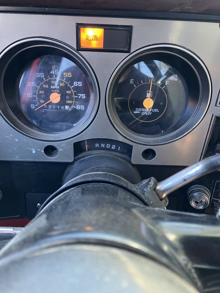

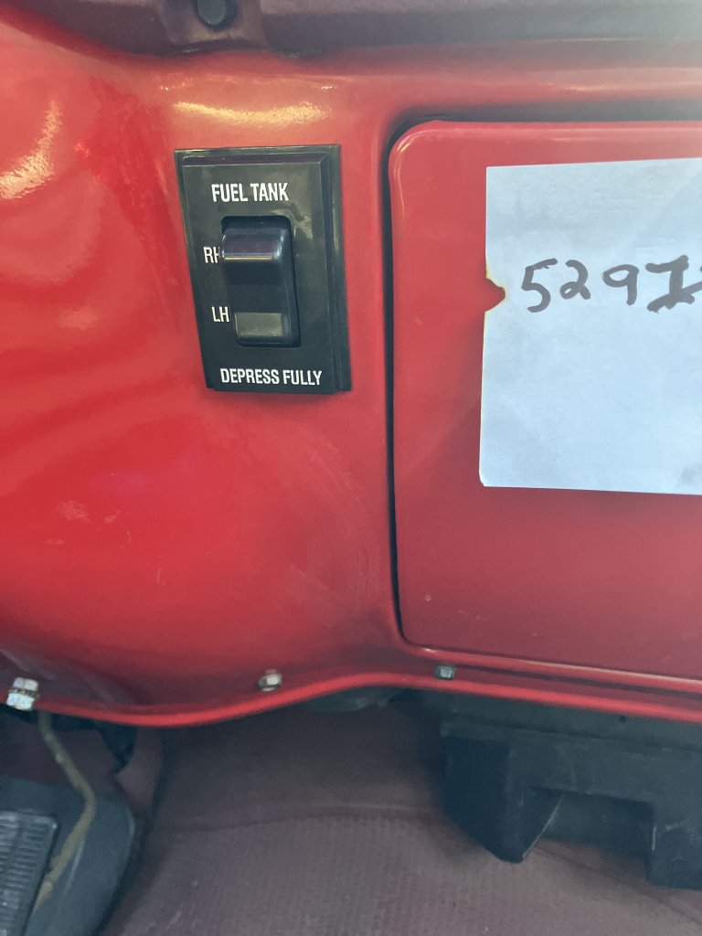

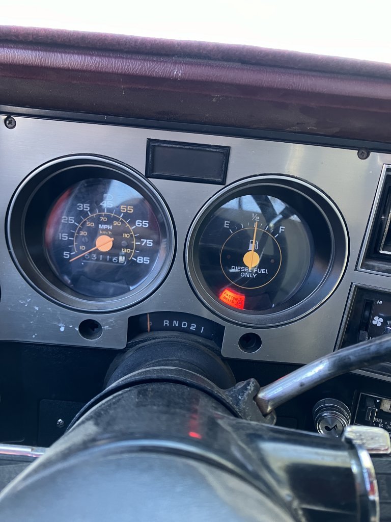

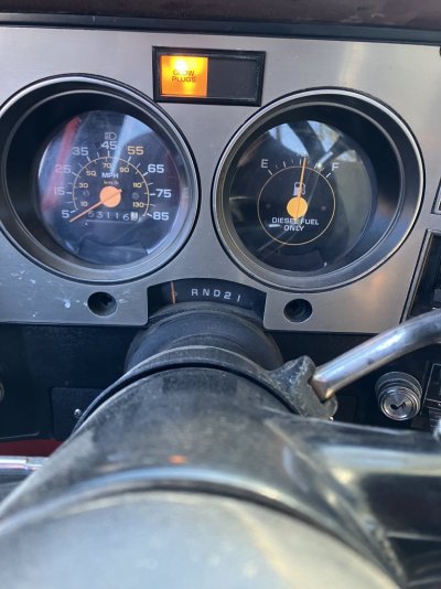

Starting procedure is. 1) turn key on, 2) push glow plug button for the appropriate amount of time determined by you, 3) and start. While this took more then a day, I believe this is the least invasive, neatest, easiest method using as much of the existing wiring as possible. While I was at it, I replaced the toggle switch with the one I bought at Rock auto, and installed, works and looks as it should, hated the toggle droopin' out the hole, but it did work. Next up is replacing the rearend gasket and oil, and the trans pan gasket an oil, oil coming...waiting for the alternator and p-steering belts to get here so I can install all three, (have A/C belt) at the same time. Gotta get ready for fishing soon, the Coho will be running, and hope to spend a week fishing on the Columbia and Klickitat rivers. Hope this will be helpful for future reference for everyone having to deal with the finnicky original system.

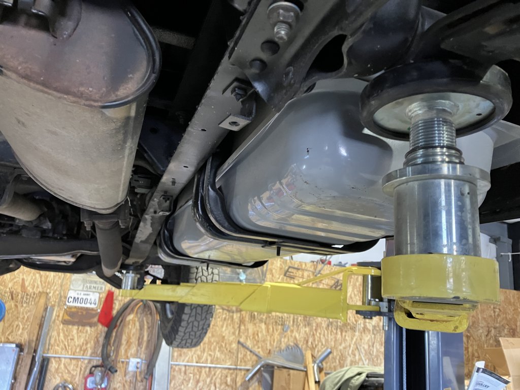

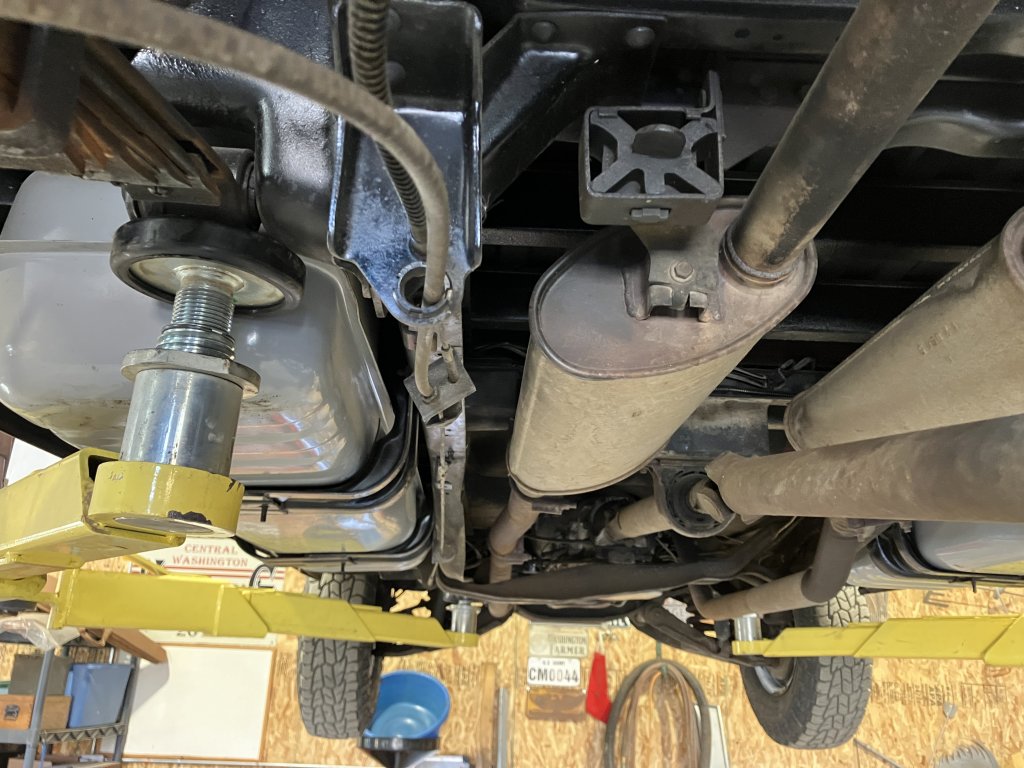

Alignment done, new tires on, smooth and goes down the road so nice. Mileage is about 24.5 mpg. Serviced the trans and rearend, parts from rock auto, everything fit. Will pack front wheel bearings and that completes the service on the C20. Few pic up on the rack, you can see how nice that raptor liner is. Think she is ready for a fishing trip on the Columbia and Klickitat river.....
